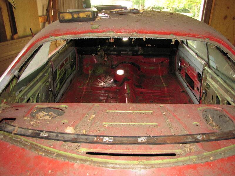

Rebirth of my 1970 GTX!

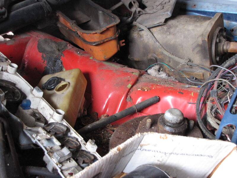

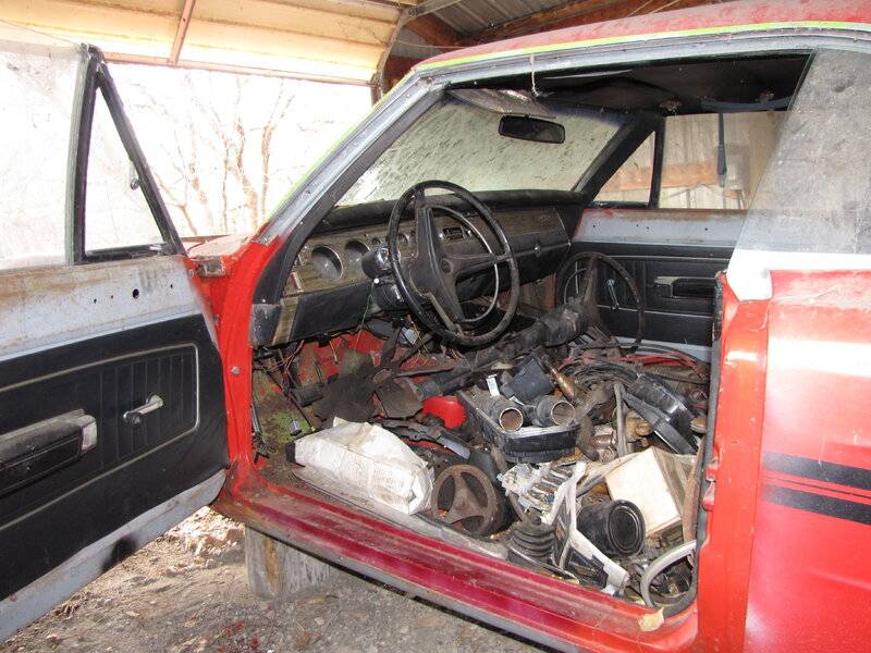

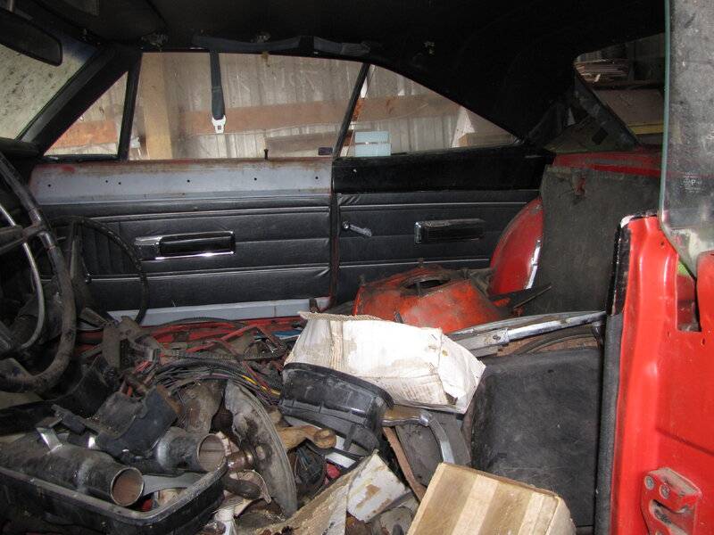

The typical pile of parts inside!

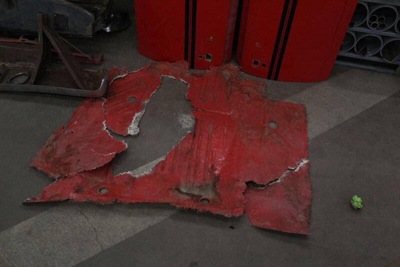

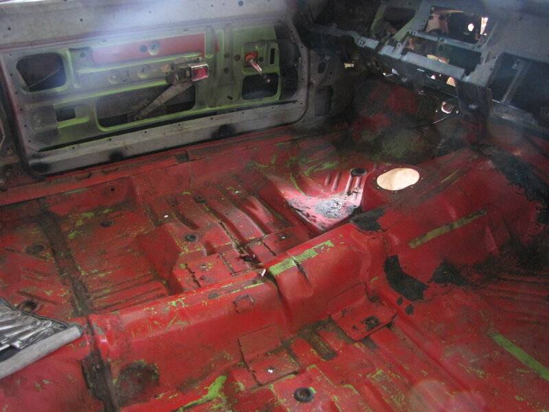

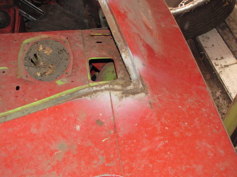

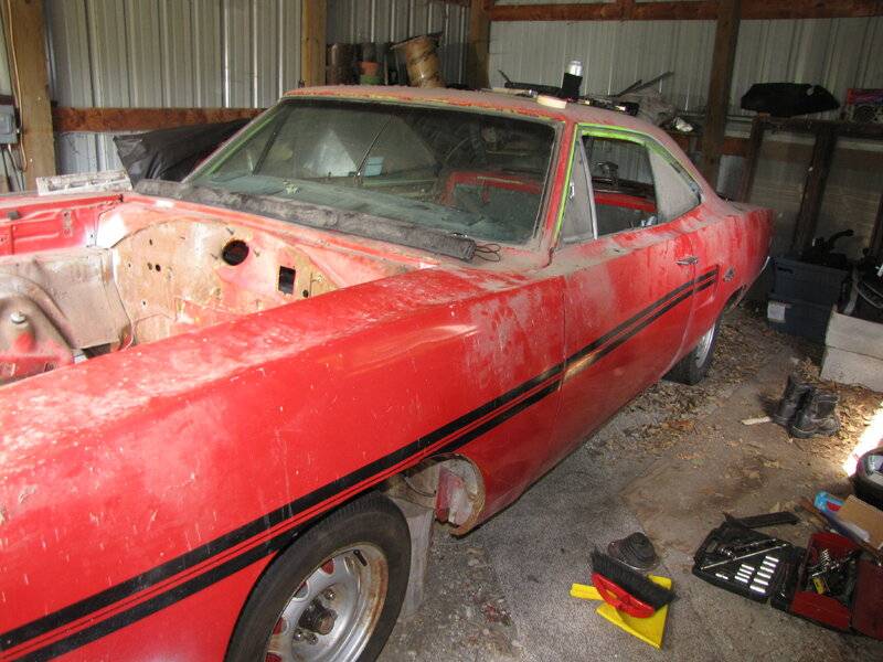

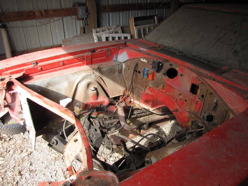

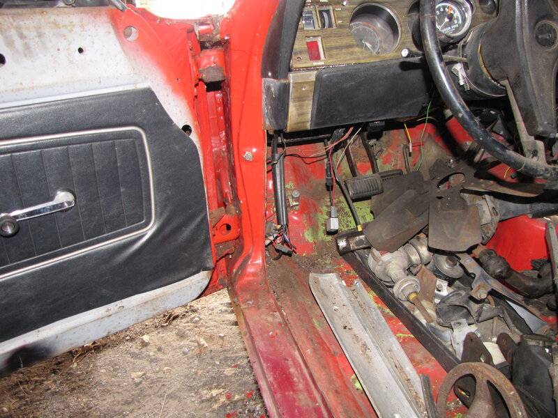

I still didn't have a garage and winter was coming so I got busy tearing things down at the farm. No lights or power out there but I got a lot done! Here you can see the buckled floor pan and some of the original Lime-light peeking through...

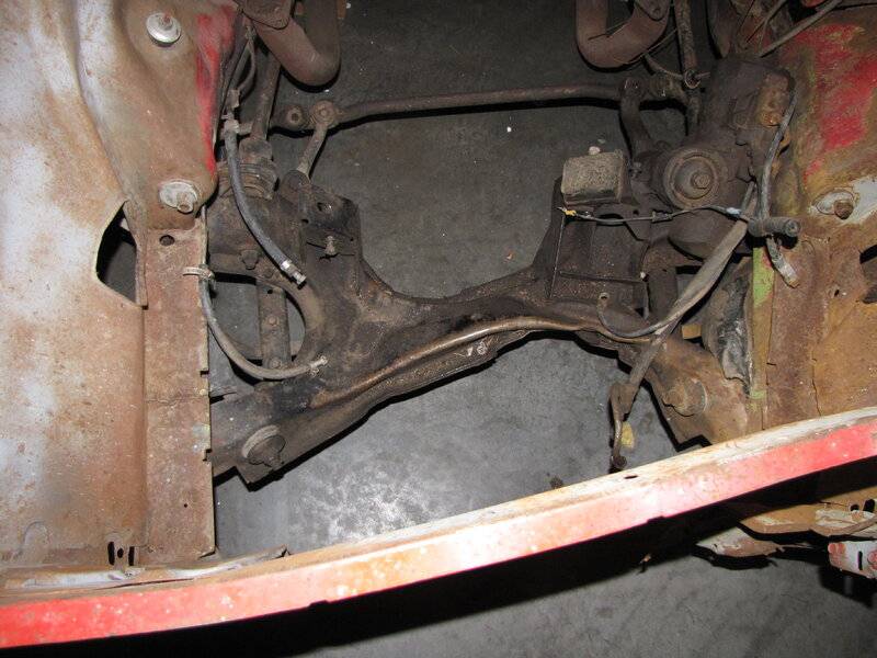

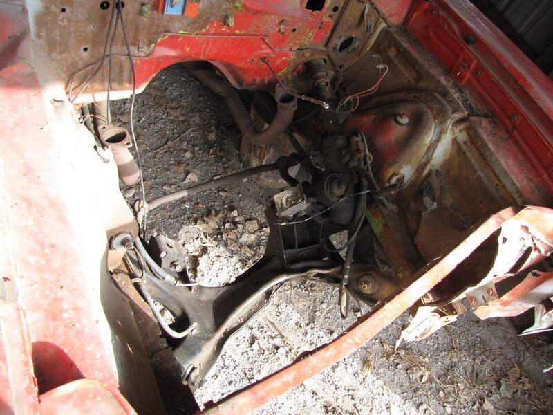

Gonna need a new K-frame! I bought one that a guy said was what I needed but I believe that it was from an e-body. They are different! Luckily I got one off a '70 Satellite at a local salvage yard!

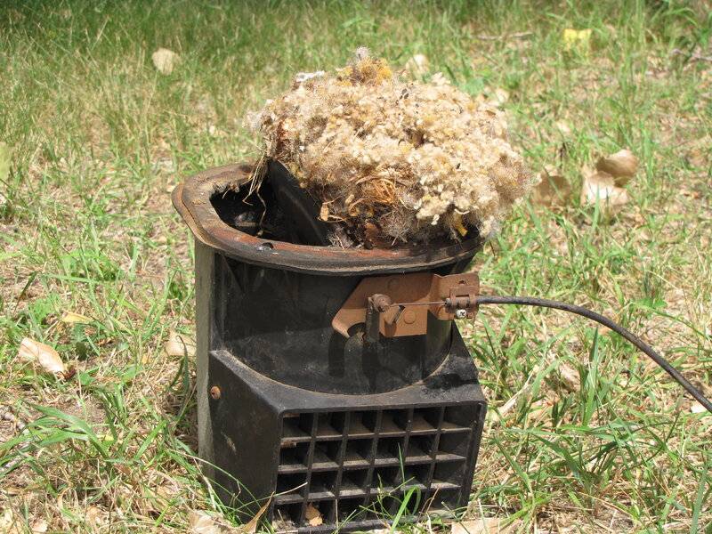

Some little critters are going to have to find a new home! I got all parts out and now you can really see the buckled floor.

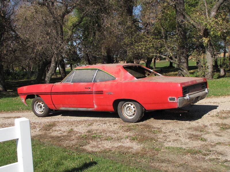

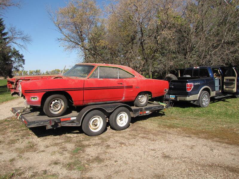

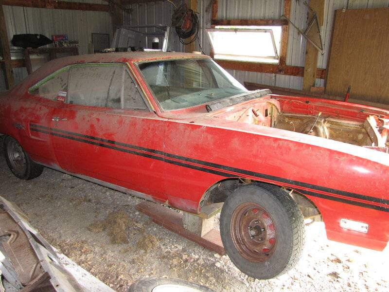

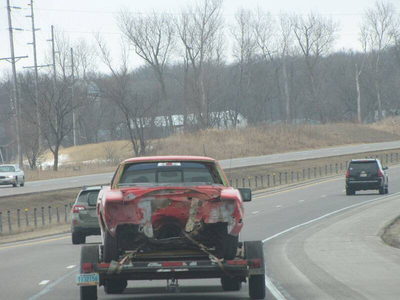

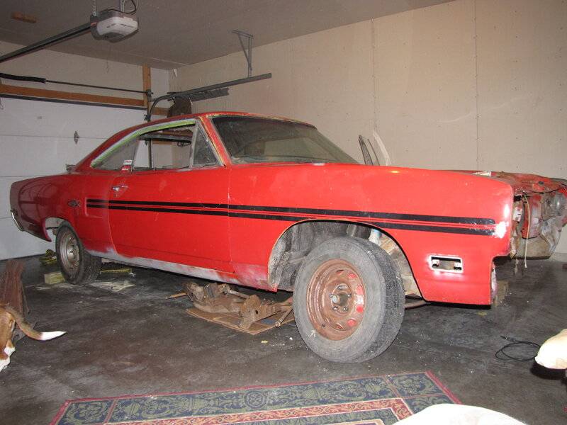

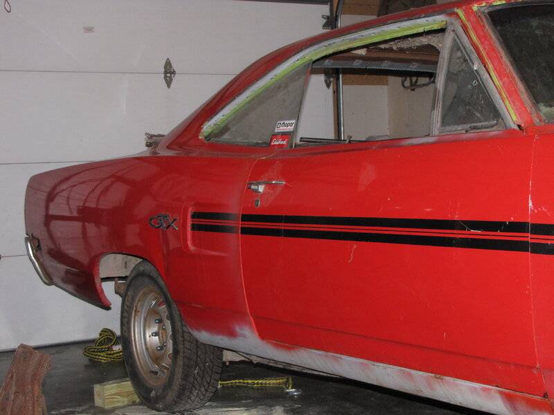

I finally got her out of the shed and onto a trailer! After a 13 year stay out there, I have a garage to bring it to! You can see damage from the crash all the way back to the passenger quarter. Both doors still open and close fine, though!

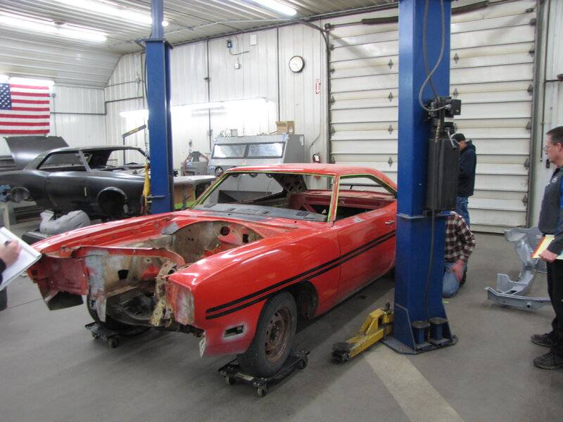

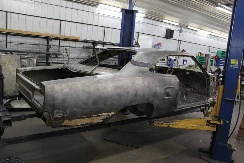

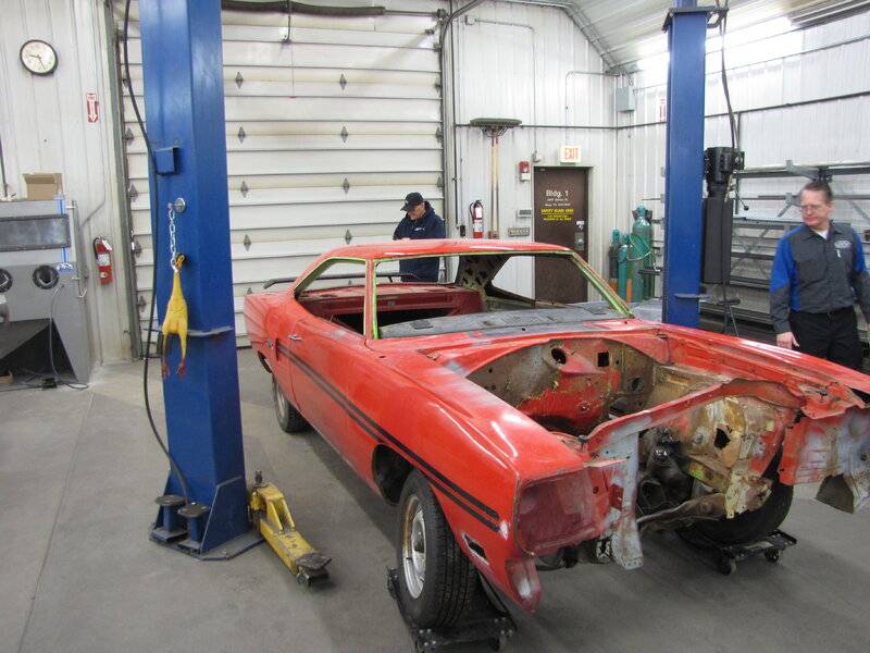

Anyways, I got the car pretty well stripped down so off to the body shop! The plan was to trailer the car and put the donor clip in the back of the truck. It fit fine in the back of my '71 C-10, not so on my stepdad's new Ford! No way that thing was going in the back of the truck! I ended up driving a minivan with a small trailer for the clip. But, I think I'm glad I was alone 'cause I had the biggest smile I ever had and it would not leave! Then tears started going...blah, blah, blah... I was so damn happy my car was going in to get fixed!!!

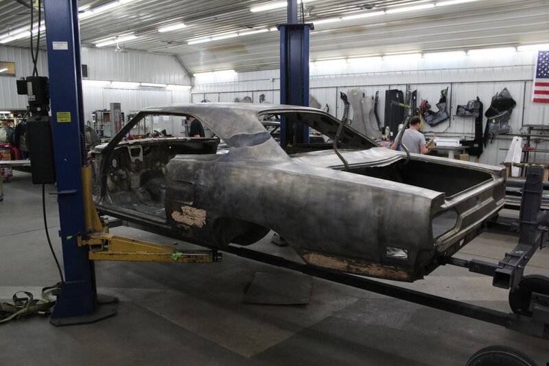

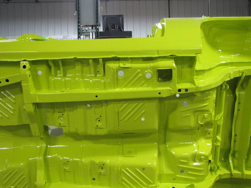

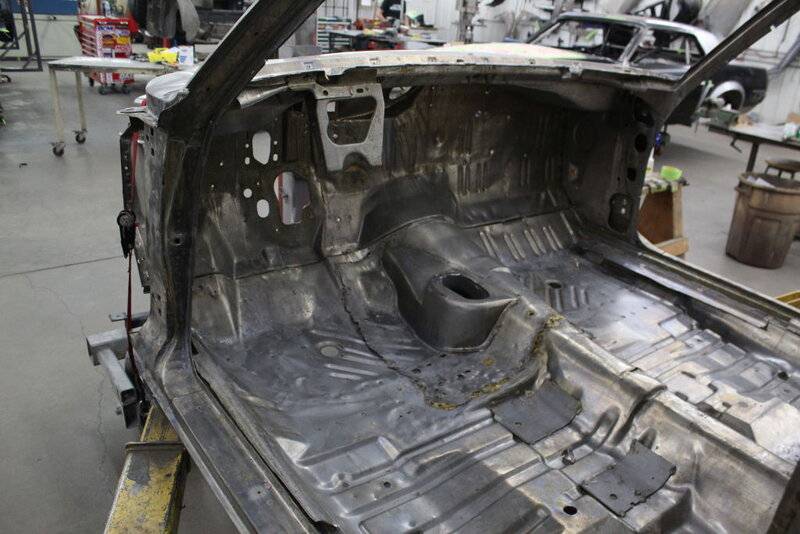

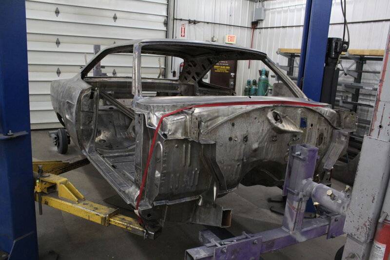

So, the car got dipped and here is what came back! Once you cut the front end off it doesn't look too bad!
Plymouth_GTX_70_001_0164.JPG Plymouth_GTX_70_001_0169.JPG Plymouth_GTX_70_001_0173.JPG Plymouth_GTX_70_001_0174.JPG
View attachment 1068450 View attachment 1068451 View attachment 1068452 View attachment 1068453

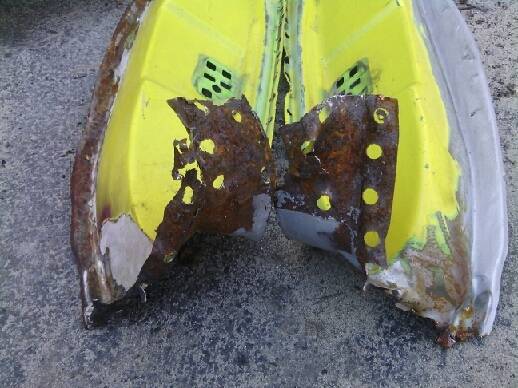

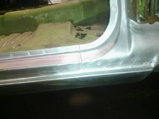

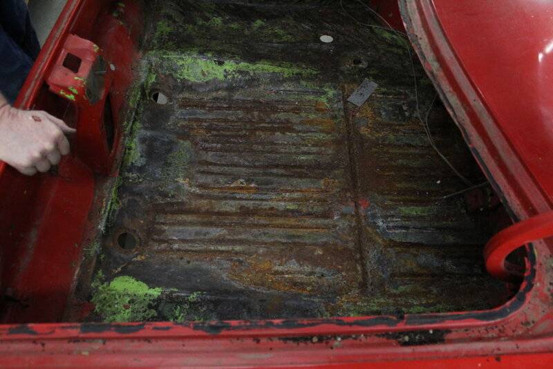

Not including the front end damage, it looks a lot like my car did - solid floors but needed a trunk floor and rust repair to the quarters. Pretty solid, so you have a great base to start with.
Just remember something @eldubb440 told me: "These cars eat metal!" Expect to have to replace more once you start digging in; it's just part of the process.
perfect example....... your door jambs were a mess, and got replaced...... we also pried open the bottom of the hinge pillars where rust was creeping out; we were able to blast, clean, and do our best to rust proof those areas....... Tempil Bloxide weldable primer is an excellent anti corrosive.....we brushed in and on, then "blew" it into the crevices with compressed air
