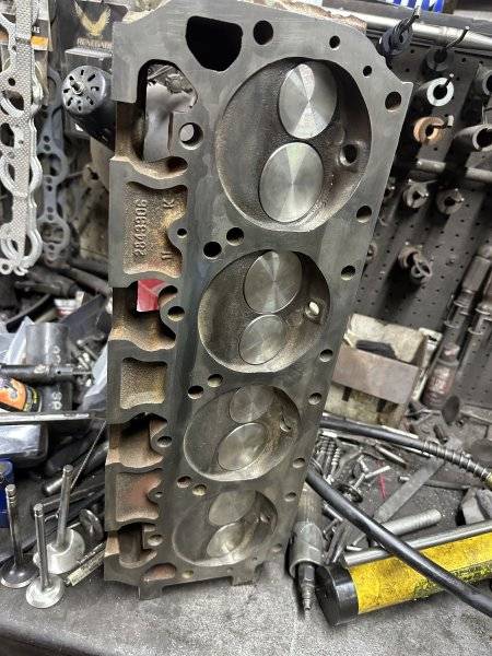

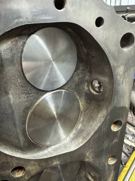

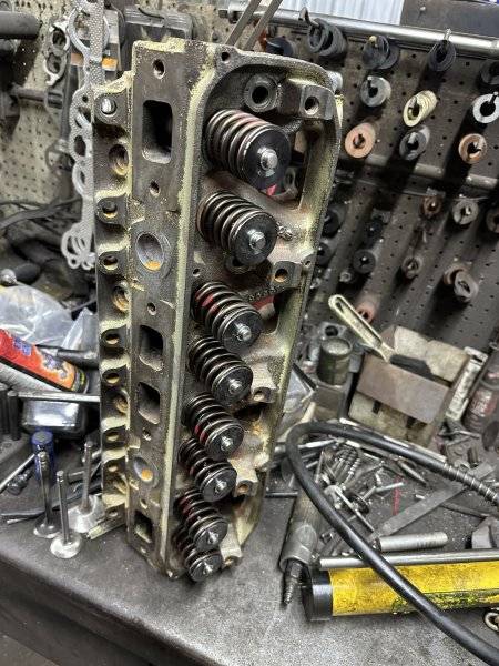

My machinist got my 906s back after cleaning them up, installing Hughes 1106 springs, and 2.14/1.81 valves
Just wanted to share with the Mopar b body community and get your feedback. Debating between running them on a mild stroker (451) build with a mild .550 lift cam. Target rpm range of 1800-6000 compression ratio should be 9.3 :1

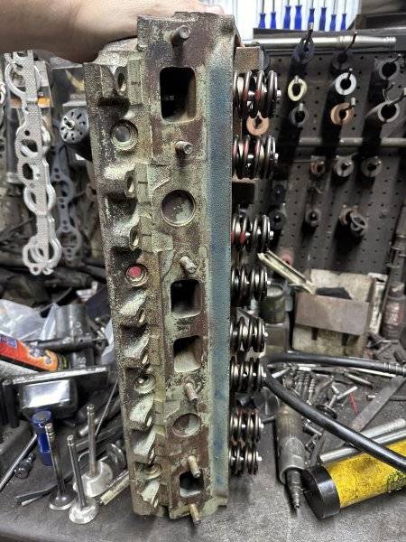

Valves & guides look nice, When you get them home , just me but I would disassemble them , add new frost plugs and do a real good clean up on them.
Should do fine in a mild build...

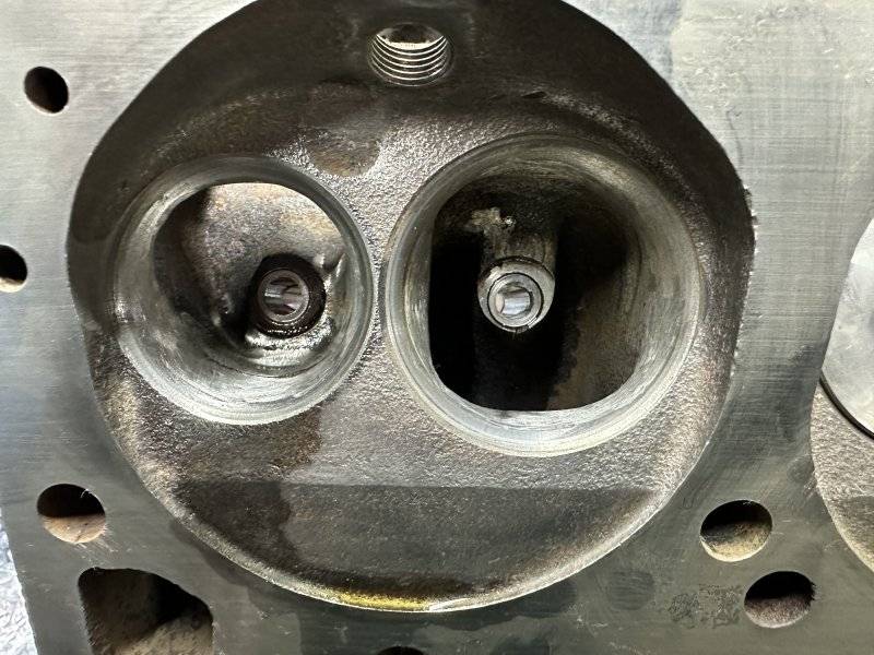

hope they cut the tops of the valve-guides to clear the .550" lift
the bigger valves will help flow some too
intake ports look mild, cleaned up/port maybe 260-270cfm (?)
should make 500hp
I appreciate all the input guys. I do plan to clean up the heads myself before install. But to be fair, my machinist treated me very good.
All in im at about $400(not including spring kit)
He said its clear up to .600 max but we discussed my cam and with 1.6s should be .552
