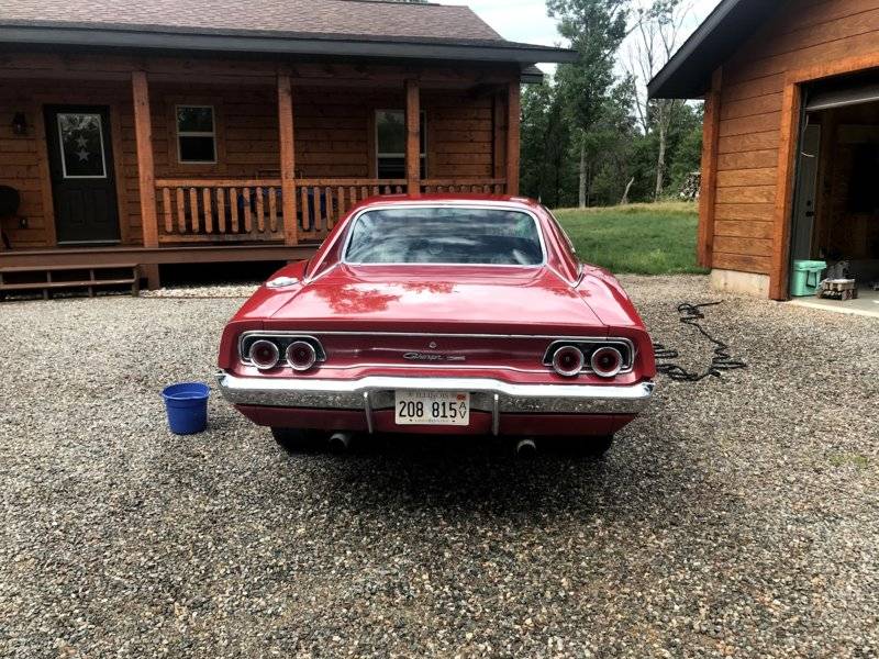

Hello all,
I was hoping to see if anyone had some advice on my next steps for my Charger. I purchased it from my father slightly before he passed away this year. He loved it, but it had been sitting in his garage for a number of years not getting any exercise. Since I have gotten it, I have replaced the carb with an 850 Speed Demon (vacuum secondaries) but not really tuned other than float level. Had the gas tank and lines cleared out, front disc brake conversion, some front suspension components replaced (tie rod ends, sleeves, shocks, idler arm, pitman arm). It is currently running pretty strong again but will bog if I mash the peddle from a dead stop. I would like it to be drivable with some trips to the drag strip. Probably more towards the latter as it will never be a daily. Going through the receipts here is what I gather of the build (it was done in 96.

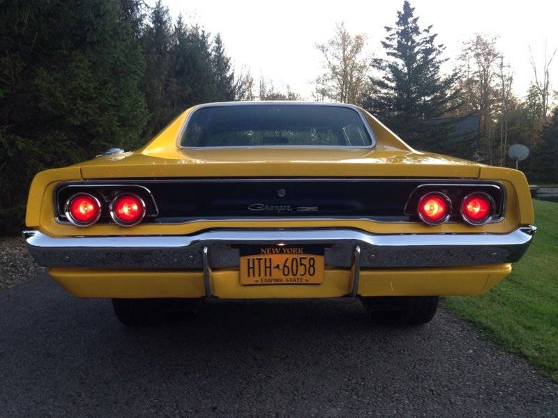

Awesome looking car. Just a suggestion....I had the same tail setup as you did when I bought my car being painted one color. I painted my tail panel in the center black like they were from factory. Adds a very nice color contrast on the tail vs. all one color. Personal preference just thought I'd toss the idea out there. Again nice Charger man! I added a pic of mine for reference.

Thanks! And yes, I plan to do that as well. I like the contrast. It could use some new paint. It was media blasted and painted back in 96 but there is some cracking and flaking here and there. I have the receipt for the paint job but no color code listed. I am hoping it is the factory red of the time. Either way, I want to get it running tight first before focusing too much on looks. Not always easy.

Yes I agree completely! I just used a satin rattle can and it turned out awesome. Took the trim off and the tail lights and had it done in a few hours. Had to do it as with the yellow it was wayyyy too much of one color. Good luck on the refresh man!
