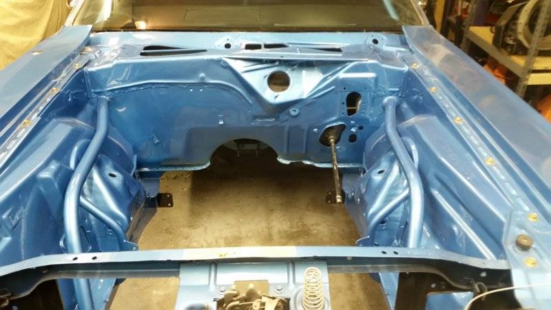

At the point that you put in j bars do we need to remove inner fenderwheel fender. Then weld the brackets for the shocks to the j bar. Then replace inner wheel fender with just flat gauge or aluminum panels.
What about the core support does it need a bracket welded to it.

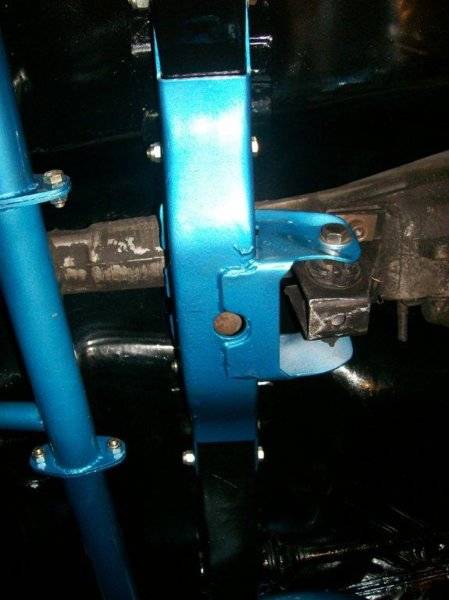

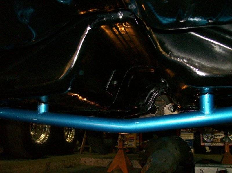

I have always called the "J" bars, "snout bars" in the engine bay. I have them on my car tieing into the cage. All the undercar bars and frame connectors are round tube also tieing into the cage. The last 2 are about the best I have of underneath.
