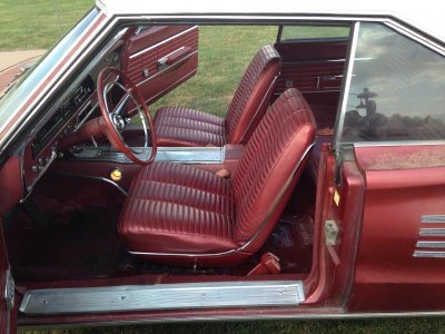

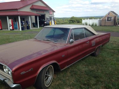

I'm redoing a 67 rt and picked up a 66 500 with 40 k on it and wanted to keep it original other than oxidation and a few sm rust spots it's a survivor
Pics
I love Meguires products. The only thing you have to remember, is the oil based polishes will eventually dry out. If you could try buffing with swirl remover or maybe a coarser polish and then wax, it will last longer. If it's a metallic paint, polishing is limited to the depth of the clear that's on the surface. I like the foam pads they offer. Red for cutting, yellow for finishing.
