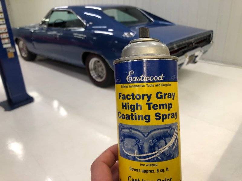

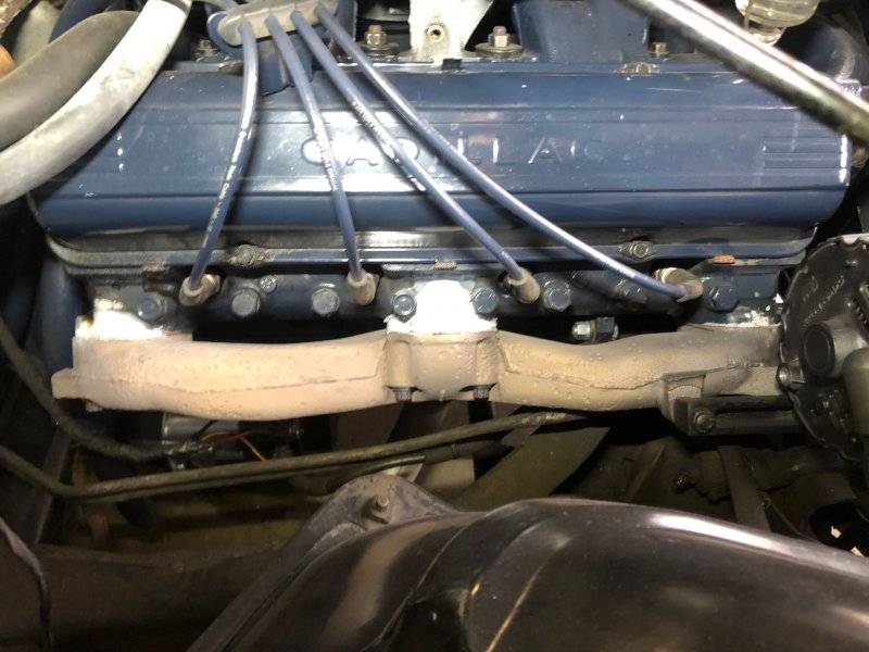

I used Eastwood on my manifolds. Here are before and after pics. After about a year of regular driving, the manifolds still looked as good as the day I refinished them.
