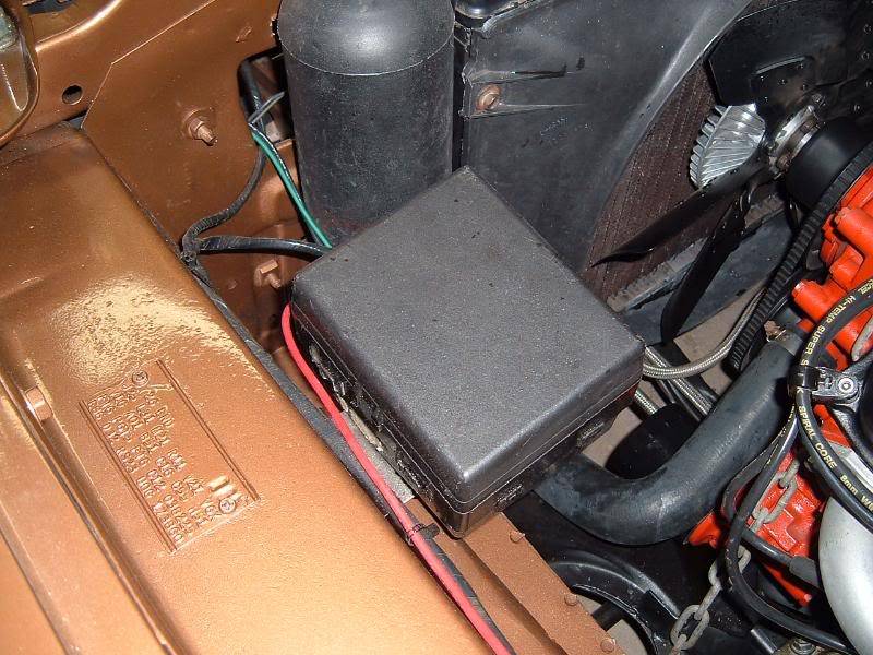

I have separate relays for high and low beams alone in one nifty bot under the hood. It may be overkill but if you look at any late model thats the way they are wired
