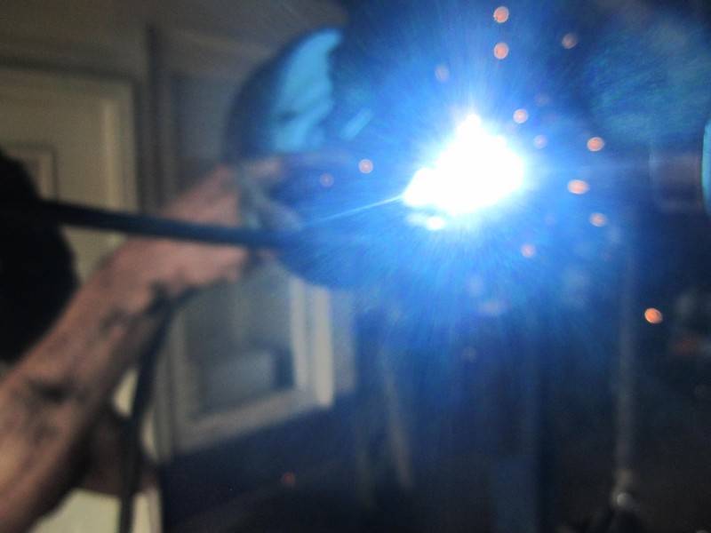

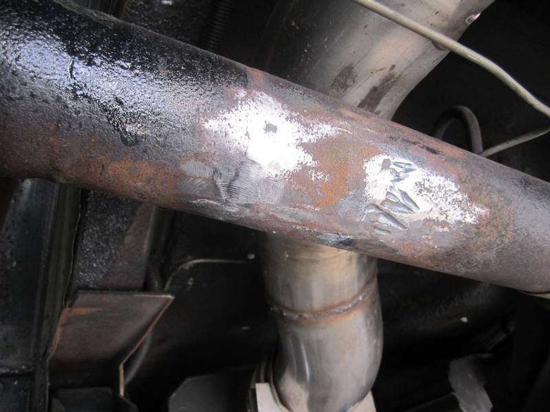

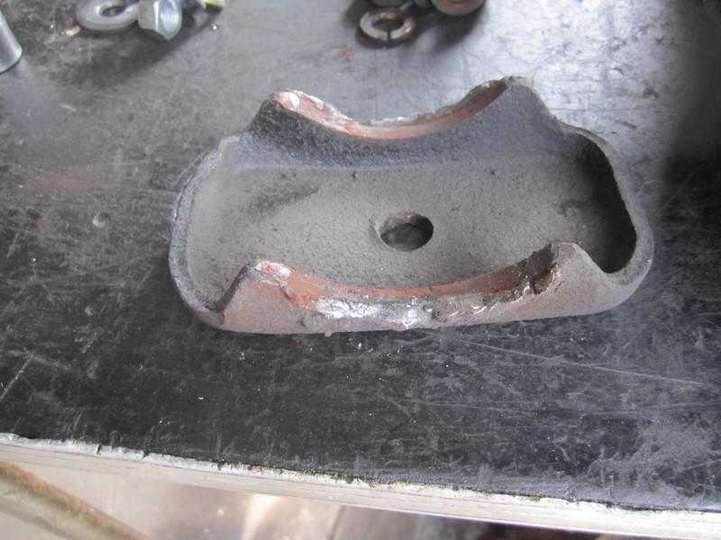

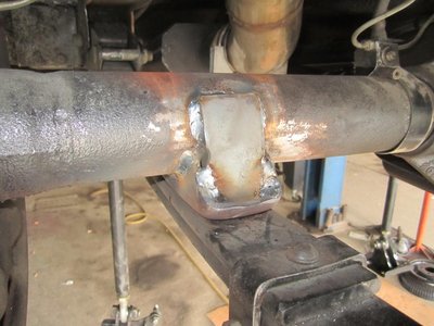

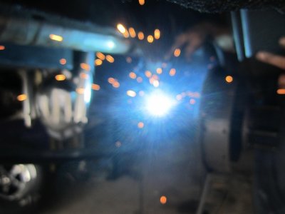

I didn't remove anything after I bent one:lol:.Install new perches without welding . Put wheels on solid surface and measure pinion angle to insure PA.I like 4 or 5* down with leaf springs.Put it back in the air and weld. If using stock perches like I did,brace the back of the axle to the per perch.:thumbsup:

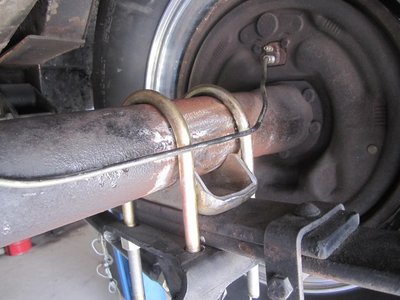

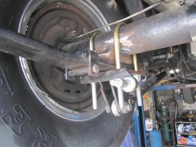

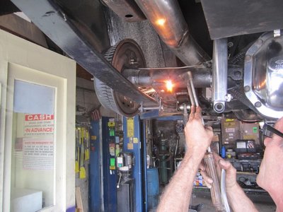

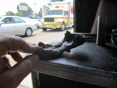

That would be correct.I don't see the need to remove anything but the u-bolts and and shocks then cut the perches off.

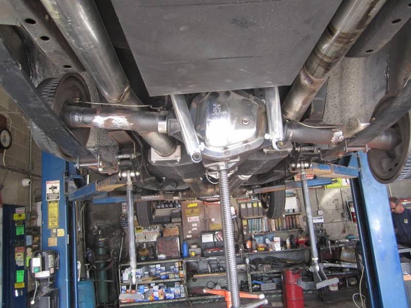

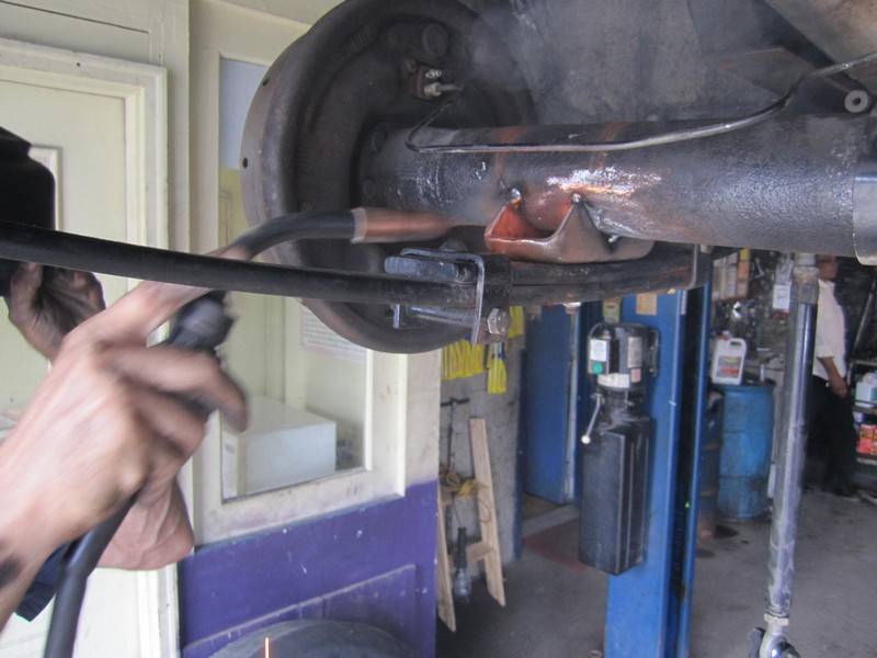

Reassembled before welding the new perches,set it on the ground to set pinion angle 5* down.Put it back up in the air,tack the perches,remove the diff housing again and weld everything up,,,,,,viola:)
I'm sorry....i'm clearly obtuse. You put it on the ground to set the PA and then clamped it in place to the leafs. You then raised the whole shebang up on the lift and tacked the perches in place. Then you ...removed the differential? You removed the u bolts and the shock plates and left the axle housing sitting on the leafs? Do you mean you took the guts out of the center of the rear end? I be cornfused...thanks for your patience...lol.

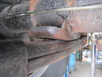

Moved the whole housing outta the way to cut the perched off and cleaned the leftover slag off the axel tube.Put it back together with the u-bolts just snug after centering on the ne,set it down to set pinion angle 6* down and tacked the perches.Back in the air again,and again move the housing outta the way and weld the perches and back brace in.
