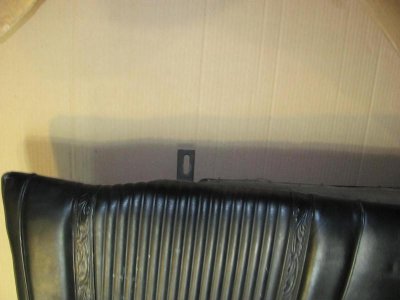

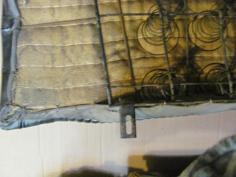

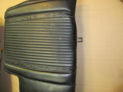

Took the back seat out of my 66 Satellite this morning. Bottom of seat is down in 1st pic, to top on 2nd & right in 3. Screw goes through tab holding bottom of seat back to verticle part of floor pan. Pull bottom of back out toward you & drop back down.

thanks a ton guys. the pliers to bend the retaining tab worked and then it was just push up pull out. however I am just a bit to big to squeeze into the trunk with the space that is open. so im going to get a friend of mine to squeeze his tiny self in and pop the latch. poor guy owes me a favor. worst case scenario I have to ask my sister to do the job but she is so ridiculously small we send her into the crawlspace in the attic. but again thanks to everyone. 66satellite47 the mounting on my sedan is just a little different but I really do appreciate the help, for others who need to do the same thing I could post some detail pictures of the mounts. it may help someone else in the future right? although I wish it was just bolts those bend tabs look like if I try to reuse them they'll snap.
