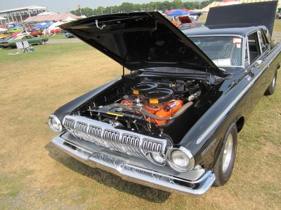

I shot this pic at Carlisle the other day thinking of THIS thread:grin:

It is a beauty! I don't know who belongs to that ride but
Same here, everytime i see them like this, maybe someday... My wife wanted me to get them done when i did my 73 until i told her what they cost to get them redone good. My rear bumper has, i guess you would call them like spider cracks through out it and all the buffing in the world wont change that.. Front isint to bad after i buffed it out, im thinking about that easy off on it and see if it makes it better. Great thread learning different things to try or use...

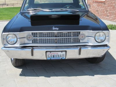

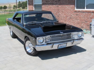

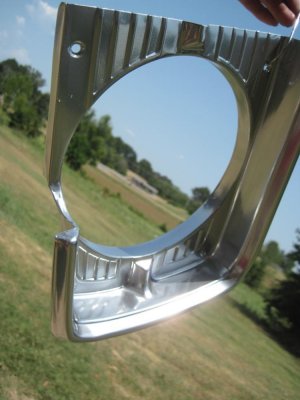

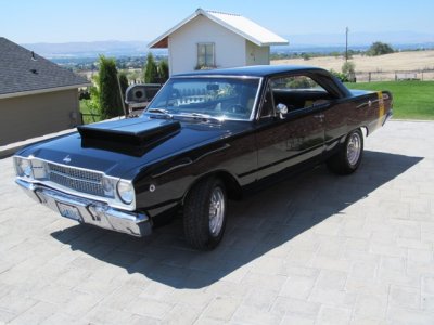

Yep, he's right about that. This is FABO member zigs' Dart with my Super Chrome and Clear Vision powders ... he wanted to go with a brushed aluminum look. He told me I hit a home run!! :)
... and after I was done with the repairs ...
The support brackets were coated in Silk Satin Black ...

And for what it's worth, I used a few cans of Easy Off on zigs' grille and headlight parts (and everything else I've restored that was previously anodized -- it works great). The trick is to let it soak a few minutes, respray it as often as necessary until you get a gray / yellowish film rising, never let it get dry, and wash it off with COLD water. :toothy5:
