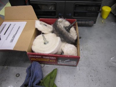

I used a product from www.bluelightning.com called anodize remover. Its kinda pricy but works well. I also used ZEP degreaser purchased from home depot in a gallon container for about $12. The trick to using these products is adding the product to very hot water. I used an old dutch oven type pot, added the zep(caustic) and nearly boiling water. Then i applied with an old paint brush. After thoroughly washing, I wet sanded some parts with 1500 grit and polished with an aluminum polishing kit from eastwood or similar.

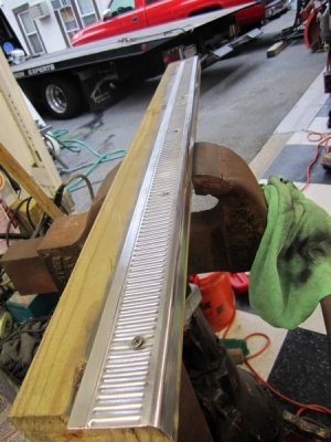

I just picked up a pair of dorr sill plates for my '63.Tried to polish,but they did not come out as nice as I would like.:angryfire:

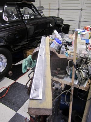

Here is a couple things i used 124 buffing compound to do, the sill plate at top isint done and bottom one started..
2nd is headlight bezels. NICE looking cars Hemi-itis and 5.7!!
My sill plates are pitted in the grooves,If I could sand 'em out they would be too thin.I'm thinking about buying new ones at Carlisle next week:eusa_think:

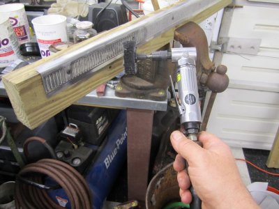

Ron,how did you hold those pieces??Did you screw them down to something like I did?
oh yea purple power took the coating off the coil springs and hardware on my duster when i went to clean it. i mean it took it all right off after i sprayed it good and rinsed it off at the car wash!!! i wasnt happy....

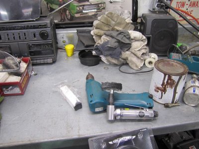

Hemi-itus, The buffing i did on that small buffing bench, i call it... I just hold onto the pieces and hit the switch on it and away ya go... You can see the small 1/4 hp motor on the corner there with the pad on it.. You just need to be careful they don't fly out of your hand.
I did go over my front bumper with it on, but it really has to come off the car to do it good.. I used the drill and pad to do it.. Thanks snakeoil24, Just some time, once you get whats needed, it isint bad work to do, propwash here is the buffing king i think :), ive seen his work he has it down pat, Its in his "Family Tradition" thread in restos section, i have no idea what page now..
so who do I buy the pads and polishing compound from???
Here is the site i used to buy pads and compounds.. The second site is one i had but never bought anything from them.. I don't remember the pad info i bought now, i got 3 different types and the compounds i called about and they told me to try the 124 brick which is what i used on these things. The 124 is a large brick and yellow in color, the ones you see are for other things ive tried, it came as a kit of 4-5 different small bricks.. Id suggest calling them and tell them what you need to do and go from there, i can only tell you what i used and how it worked, which im happy about.. Look around this site im sure you'll find plenty of info on what everything's for, its been a long time now since i bought from them.. Good luck..
