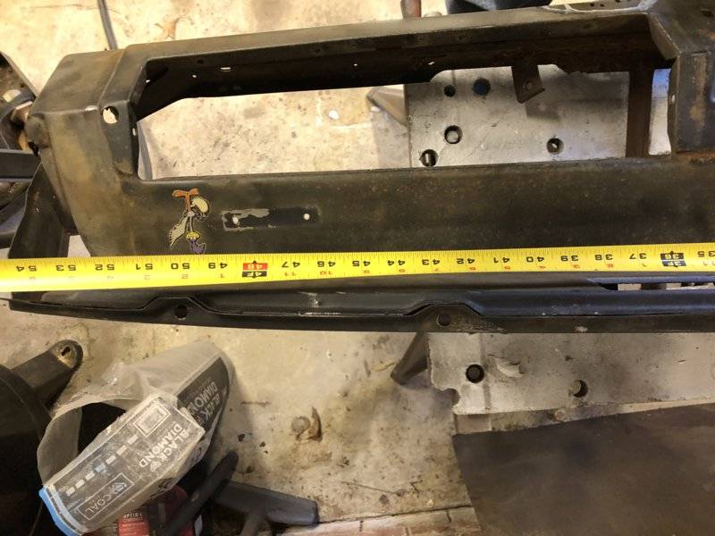

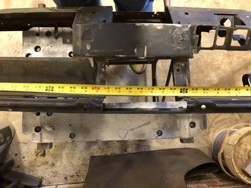

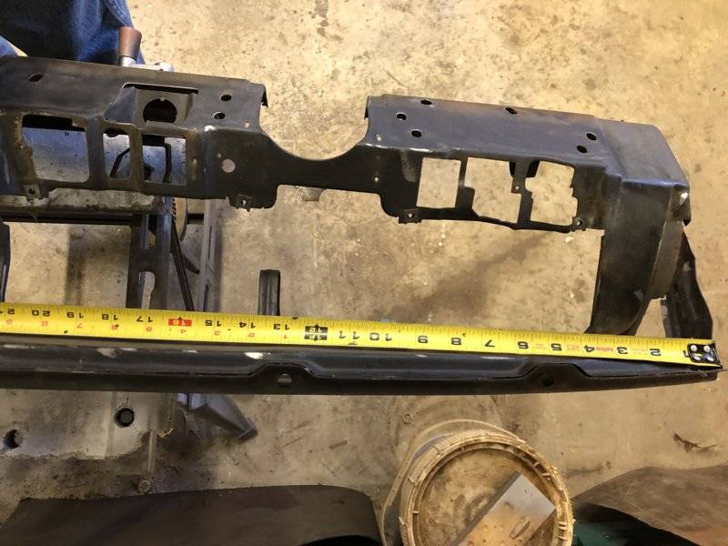

I have my entire dash out so its pretty easy for me. Some things to note:
The nuts are actually speed-nuts so pretty easy to get off.
The spacing is uniform, but you gotta find the first one. The pics attached might help.
Good luck
