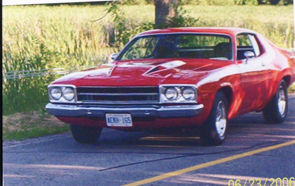

Hi guys.I am from fabo i have a 69 dodge dart with a small block i know this an b body site,but cant get the answer i need there.Could someone here give me step by step how to remove my k frame, t bars, upper a arms lower everything.The motor is out.I need to rebuild my fromt susp, ball joints bushings.My last car tho was a 74 roadrunner was a fast 360.here is a pic of it.Or is there a site that can give me the how to to do this jod .Thanks Don Belleville Canada.:)
