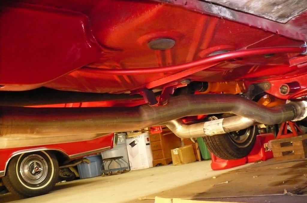

If your car is stripped down like Mocajava's or ALL flammable material plus gas tank and fuel lines a 250,000 btu heater will warm the bottom of car and under coating will scrap right off. You may not want to run it full blast until you get a feel for how it works. I did it on front inner front fenders around shock mounts, undercoat was 1/4" thick. Sounds crazy but done with care it worked for me. My car didn't have undercoating on the whole underside. A friend of mine showed me how to lay the car on it's side, no front fender and the quarter was damaged. Didn't do any more damage but it it was a little hairy. Used some 4x4 to prop it up so it wouldn't fall onto it's wheels.

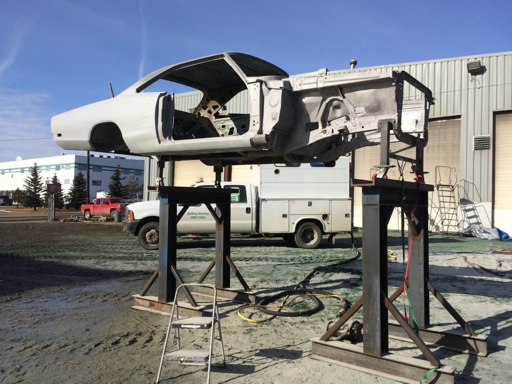

Sand blasted the floor pan.

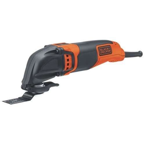

I actually used one of these and liked it better when it wasn't heated. That way it seemed to come off in chunks. Use a grinder to keep sharpening the blade.
