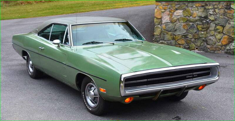

So at some point in its prior life, someone added adhesive-mounted, thin plastic/rubber rub strips on the side of my '70 Charger. They're not factory, they don't have any rivets or hardware, they're just stick-on.
And, they're ugly.
Anyone have any ideas on how to dissolve the adhesive? I've read about citronella tiki torch fuel...something about the citrus...
I hate the moldings, but I really don't want to paint this car since it's original, if I can help it.

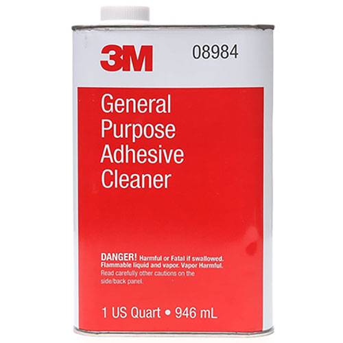

3M makes a spray product used for safely and softly removing weatherstrip glue.
I have used it a million times on old lacquer paint as well as enamels and BC/CC -
spray it on, do small sections and use a plastic edge to lift and help roll back the bump guard. (don't leave it sit on for a long time, specially on lacquer).
GO SLOW and don't pull really hard - patience. Might tale you an entire Saturday to do this.
Heat helps too. Park the car outdoors on a hot, sunny day.
The 3M stuff is good. I haven't used the aerosol version.
Above all else, patience.
A good solvent based wax and grease remover normally works on adhesive as well (RM 900 for example).
The most gentle product I know of is WD-40. It will soften the adhesive and evaporates
completely. The 3M 08984 product is the best!

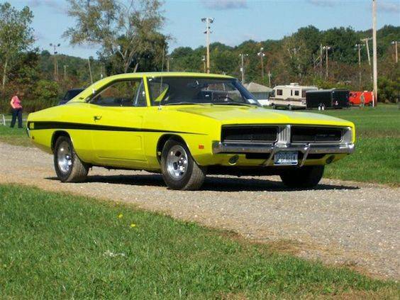

worst case scenario you could always do a dirty Mary thing :hitit:
