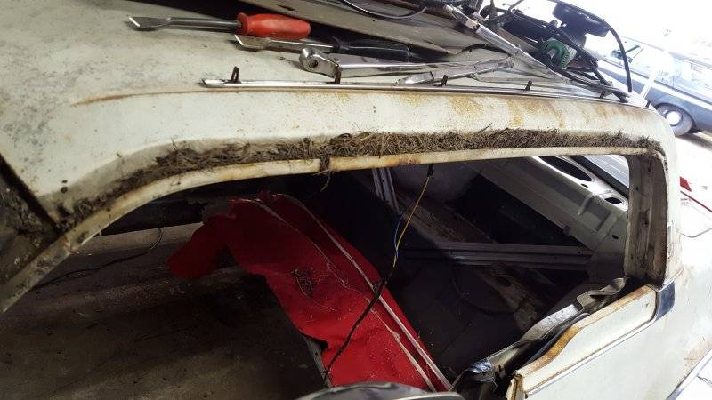

I do not have a lot of pics of removing the trim, but found a few.
First shows I removed the upper and lower trim first, second shows the mess under the roof trim.
The rusted out trim clips on the upper and lower windshield trim probably made it easier.
