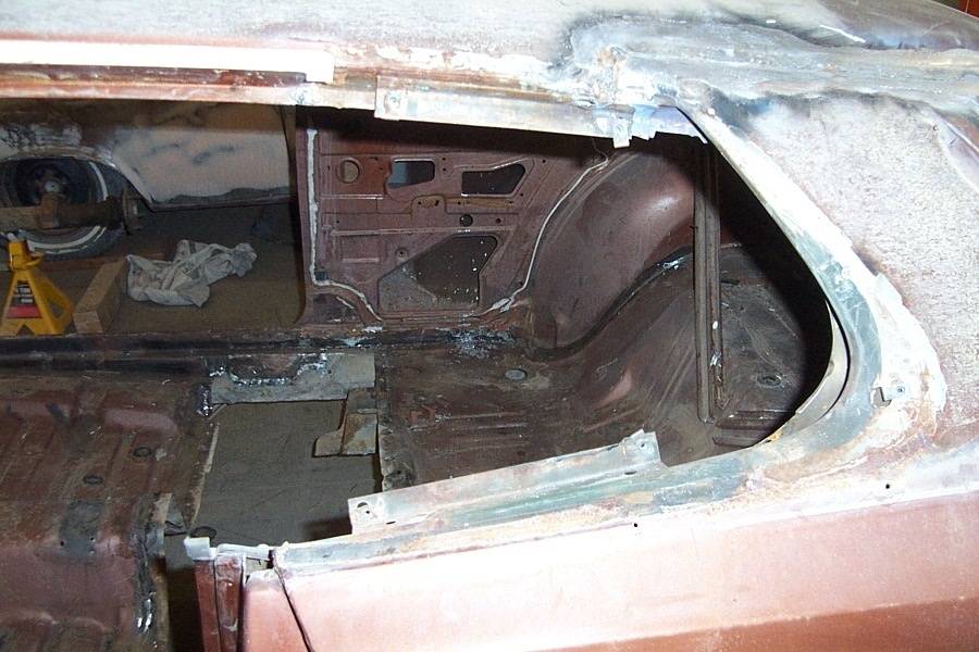

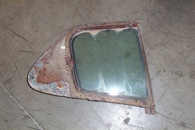

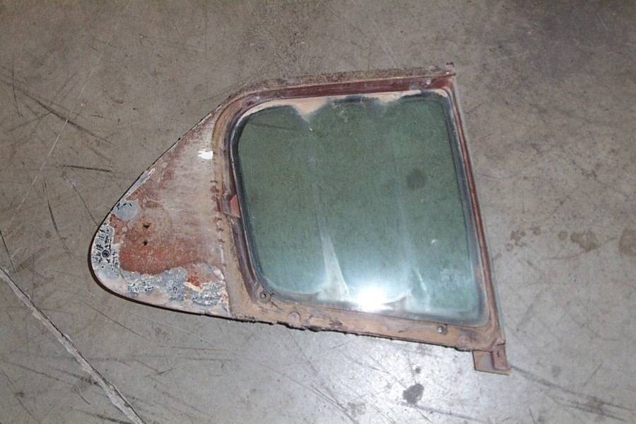

There is a semi b-pillar that you will have to drill out. You will also have to source the quarter glass and regulator, they all bolt in. Door jamb will need to be trimmed for the glass to raise fully. The only real issue, aside from parts sourcing, is the drip rail which is shorter on the SEs. Not impossible but certainly harder in Aussie land.
Here is a 73 that I took apart.
