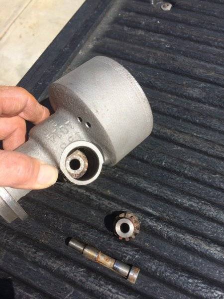

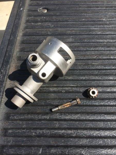

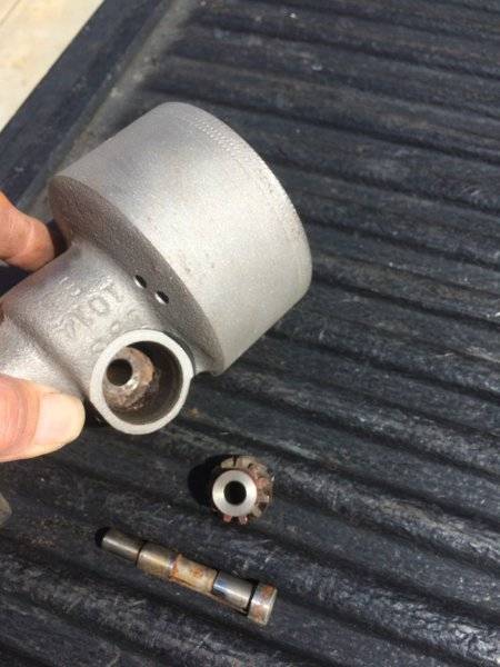

So, I proceeded to the solvent tank after freeze plug removal and got it all cleaned up with a final blast of brake cleaner. Wow. The old grease was more like glue. The gear drive moved effortlessly spinning in the bore. As you can now see after solvent clean that the assembly is an interference/press fit between the drive stem and the gear. See 2nd photo. I could not resist the urge to grit blast, so I cap plugged everything and proceeded to the cabinet. I blew grit past the plugs into the drive. I know, Jenious, right!? Wish I'd stayed on the internets long enough to catch HALIFAXHOPS' trade secret to wrap tape around each cap plug for tighter fit. So, I have a press and some 1" diameter thin wall tubing. I don't trust my multiple floodings with brake cleaner and air nozzle removed all the residual grit. I'll post my results later.
View attachment 768896 View attachment 768897 View attachment 768898
So, I made some more progress today and glad I did. Important to note I had the right tool with a benchtop press and did not injure myself or damage the components. There was residual grit stuck to tar that was once grease. The grit would probably have stayed glued to the old grease, buy why take a chance?
