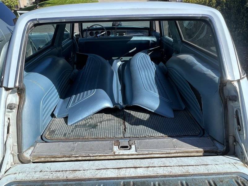

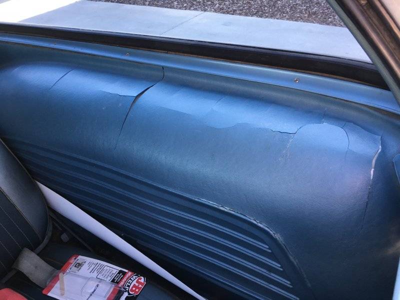

Repairing 64 wagon rear interior wheel well covers

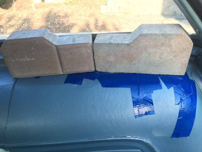

That looks like a good way to fix it. Does it look like it will stay and not come loose? I found it hard to keep the right pressure on some of the contours until it was cured.
I think so. But I guess only time will tell.
That was a challenge. As you can tell from the photos it isn't perfect, especially the one area that appears to have a peak running about 12 inches from front to back.
Dude, for what you did those turned out nice! I used to do vinyl and leather repair and I couldn't get them that good on the first shot!
Basically. I'm putting the epoxy on the back side as opposed to the top. But I'm hoping to have similar results.
Hopefully there was enough goop that leaked out to help seal any gaps, which it looks like it did? Good Luck

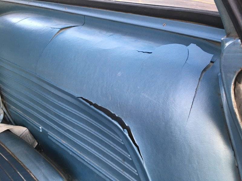

So, with the driver's side turning out decent I'm now planning to tackle the passenger's side. I'll see what the weather is like this evening when I get home and if it's not too cold I'll probably get started on it.
I finally got around to working on the passenger's side. We had a couple of warm days, which were perfect for moving the old plastic around and getting it into place. There are way more cracks and such on the passenger's side, so I decided to do it in two phases.
Not as good as the other side, but better than it was before:
Just a thought but if you can get them back into reasonable shape you could use them and make a fiberglass mold, then you could use that to make yourself some new ones. Its time consuming but not all that hard.

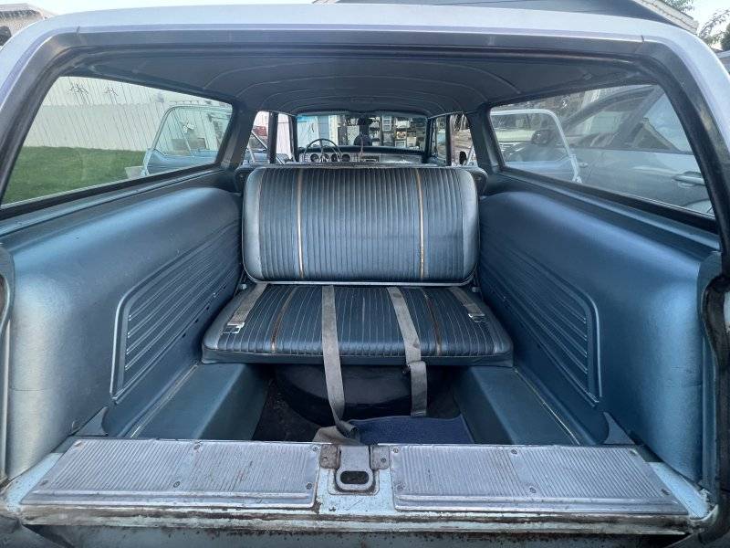

Reviving a two year old thread here, but I figured I might as well share with y'all.
I was able to purchase a set of used inner fender covers from member Parts Stalker. I had them refurbished by a local guy and then installed them. They aren't perfect, which is great because we use this car and I wouldn't want to be worried about having to use kid gloves in the back seat.
Really pleased with the way it turned out.
