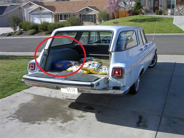

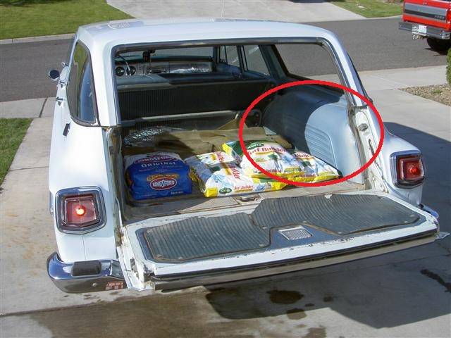

I have been told that the factory parts catalog called these pieces "molded resin."
They are the in the rear seat area of the Fury, the plastic pieces that cover the entire rear wheel well housing. They go from the tailgate to the jams of the rear doors.
These pieces:

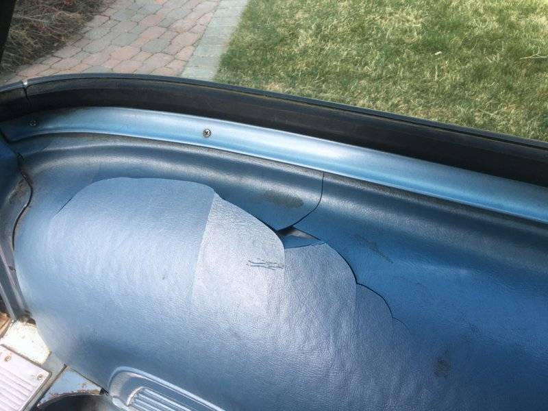

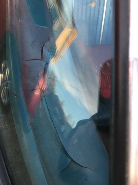

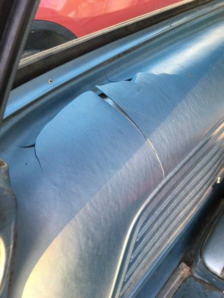

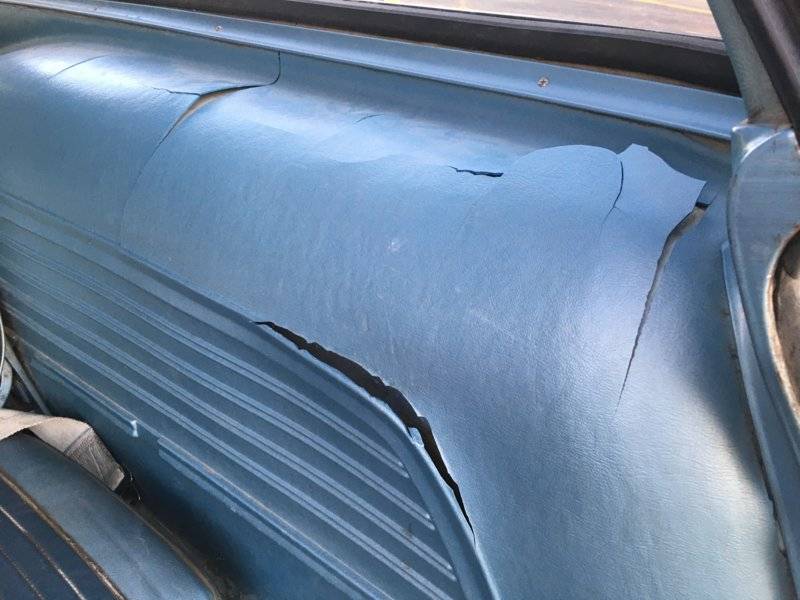

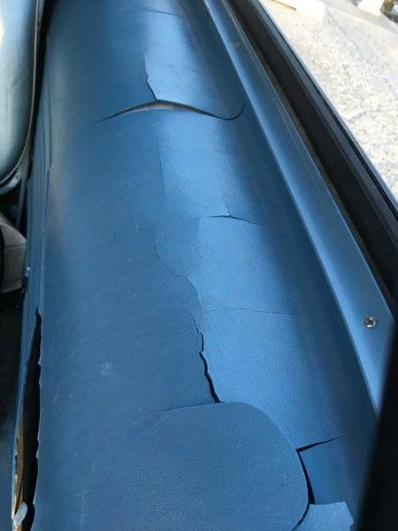

Mine are cracked pretty badly. It has really started to spread in the last few years.
Here's what they look like now:
I've done some looking and not surprisingly I can't find anyone who offers these aftermarket.
So it looks like my options are to repair what I have. I'm looking for suggestions on how to proceed. I figure someone here must have had to deal with this type of repair before. I figure covering them with vinyl is an option, I'm also thinking about ways to try and glue them back together.
Anyone have any experience in making repairs like this?

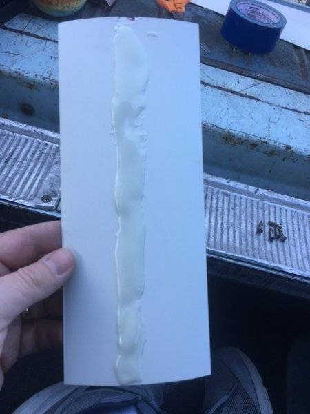

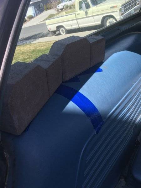

OK so I decided to take a whack at repairing these pieces over the weekend.

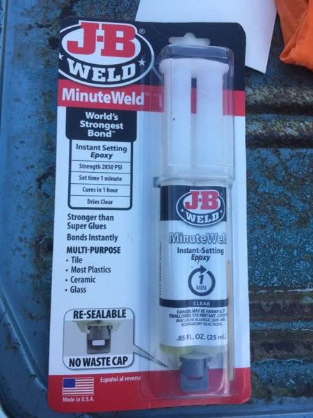

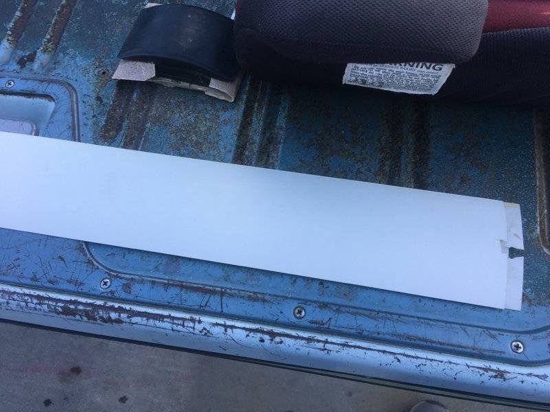

First I removed the trim under the window and then carefully pulled the top back so that I could access the back side. I purchased some plastic specific two part epoxy and then grabbed some old blinds.
I cut the blinds to the right length, sanded them so that they had a rough surface, wiped them off and then mixed up the epoxy.
I tried my dangdest to get everything lined up right, then I taped it off with duct tape and added some weight to help everything set in place.
I'm not expecting it to be perfect, but I'm hoping it looks decent. I'll be checking it out this evening when I get home from work.

J you are doing the repair like I did. Weights,tape and I cut wood to length to wedge in some places too. I hope that works I need to fix the panels in my new project too. 64 Fury wagon. Jay
Basically. I'm putting the epoxy on the back side as opposed to the top. But I'm hoping to have similar results.
I had removed mine and they were pretty dirty on the backside, so I hope your repair sticks and works.

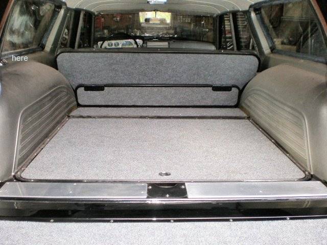

I got lucky,never needed them,gave a decent set to a friend,probably still has them,I'll check if you wish.

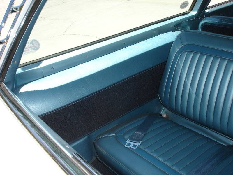

My 64 880 , had the same wheel well cover . I just had them redone in vinyl and had carpet inserts to match the floor carpet and used the same carpet on the back of the seats.

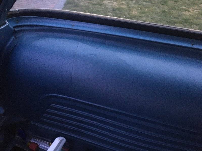

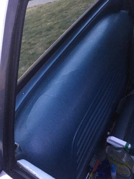

I uncovered the passenger side this evening. It's not perfect, but it's much better than it was. I took a couple of photos, but the light wasn't great. I'll post them so you can see how it looks.
