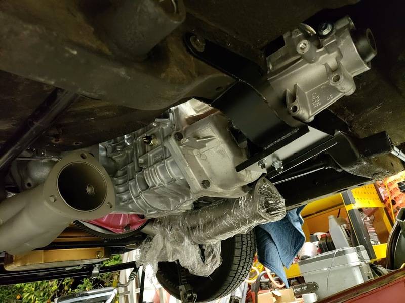

She fought me, but it's in.
OxNe4RiEA8yiMXPGRGTesuHMjur6xvqzWl-cm1_XgUuqFU0ix96LerUd5A5TwFUWAr-Ya0N-5DXpTpn7ao=w1302-h976-no.jpg
Nice install. Clean. The early Keisler TKO that I have now has leaked like a sieve from day one. Been in for about 15 years, 70k. Throws nicely onto driveshaft for even distribution to entire undercarriage.
I got the proprietary Tremec Branded break in fluid and the next change. Synthetic blend per SST.
I have to call today to order my Driveshaft.. I will ask about the oil issue..
Derwud, did you convert from auto to a tko? Looks like you were able to do install on jacks also, was that the case?

WM, yes I converted to TKO from Auto.. I have done it in the hardest way possible on jackstands..
So I talked to Chris at Silver Sports.. He said to use the Snycromesh for break in and the Tremec oil or Syncromesh after break in.. Driveshaft should be showing up in 7-10 days.
