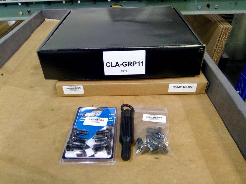

I’ve got their Slayer clutch/pressure plate, no break in and works excellent!
Forgot to say it’s rated for 700 plus hp.

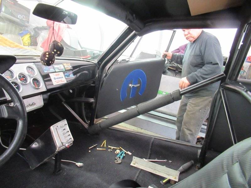

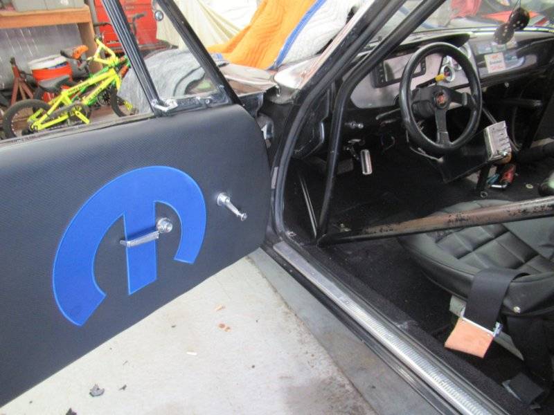

Gave up the manuals 30 years ago.now I will NEVER give up mu push buttons!!
Your "push button solution" really caught my eye in a pic some time ago. How you were able to incorporate them in the environment of the interior of your car is impressive.
I have to ask you though, why? They are simply a cable operated system for doing what a lever, be it column or floor mounted, would do, and in a more performance friendly manner I would think, what with the detente, gates, lock outs, etc. I would think that the SlapStick, which I had in my 71 Charger R/T and I incorporated into my 79 R/T, would be more conducive to the "race track" requirements of an automatic transmission shifter.
What am I missing, or are you just that enamoured by the pushbutton shifter?
