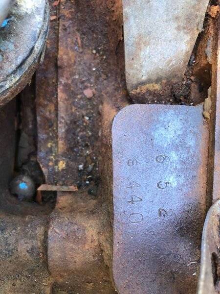

Does this look like a replacement block? Cant get a picture of the side to check to see if it has a vin.
I will offer my semi educated opinion, as no one else has come forward. Yes it is a replacement block. The s stands for service, and the 652 is the code / part number for the engine assembly. I do not have a list of those numbers, so it is an educated guess.
Also depends if its usable, or a boat anchor. Looks a bit (lot) crusty.
