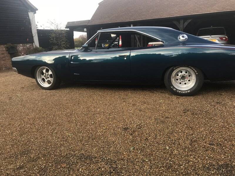

My 68 charger is now ready for an engine was a 440 which is on the floor
the 727 is fully rebuilt with upgraded internals.
Car is fully restored with smoothed enginebay and painted so dont want to modify bulkhead or tunnel
Looking for around 450-500hp Will want to get a ready to go FI motor setup to drop in
What are my options and who do i use
appreciate any advice
Interesting looking restoration....is this a caged race car now?
I don't want to be 'that guy' ....but it looks like your panelbeater messed up the location of the fuel cap. :)

I have made quite a few body mods so not a concours car just done it how I wanted it to be
Not a caged car interior and new glass not fitted yet
