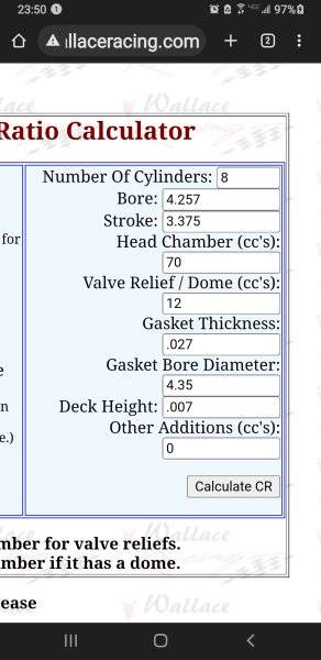

The 383 picked up freshly rebuilt (albeit 25 years ago, came from storage). Same heads/gaskets/cam/rockers/carb or efi will go onto the choice engine. Also have Performer RPM for 383.
12cc dished pistons but only at .007 down.

The 440 will be about 7.75:1CR

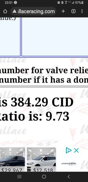

The 383 will be about 9.7:1CR desktop dyno was coming up with 450tq @ 2100..stays above 390 to 5800 rpm. Roughly 440 HP at 6100

I got 9:1 cr for the 383 with the dish. I would run the 383 with a different cam, I would prefer revving a 383 with decent compression vs a motorhome 440.
Compression ratio will be closer to 8.5 to 1 and will most likely run very well on low octane fuel with a well dialed in ignition timing. Should have very good low end torque and be able to run a taller gear ratio without being a slouch on the low end.
I mistyped...heads are 70 cc.

I think you need a new calc kramer.
