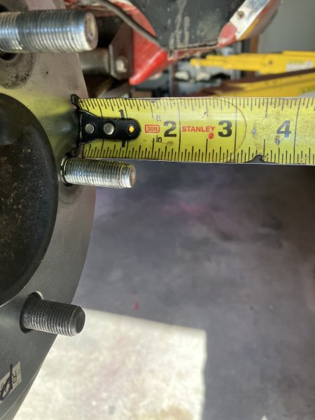

Here is what I used on my own car, it isn't a drag racer build though.
Stock length was short and didn't allow enough thread contact with my aluminum wheels. You can see the shiny replacement in the background above.
Stock was 15/16", the Dormans were 1 1/4".
