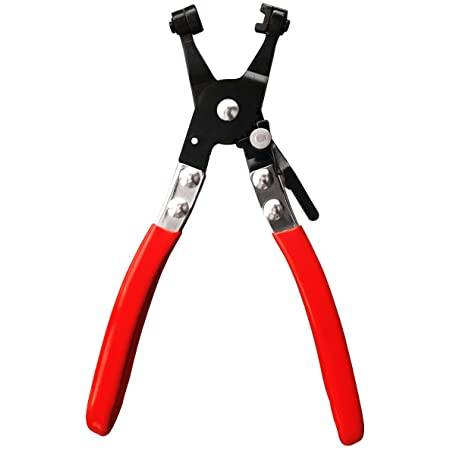

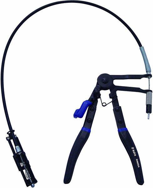

Get yourself one of these-
...and one of these-
Already have the hose clamp pliers. Vintage, from a Mopar dealership even.
