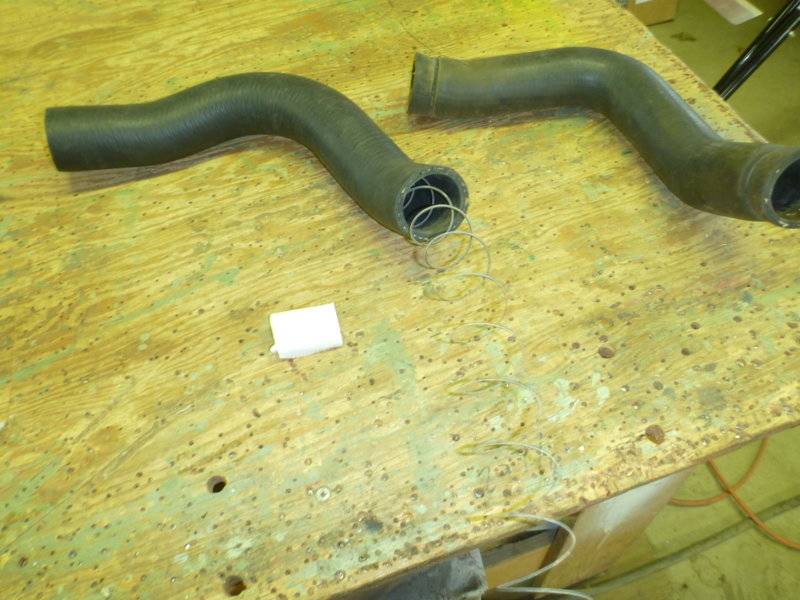

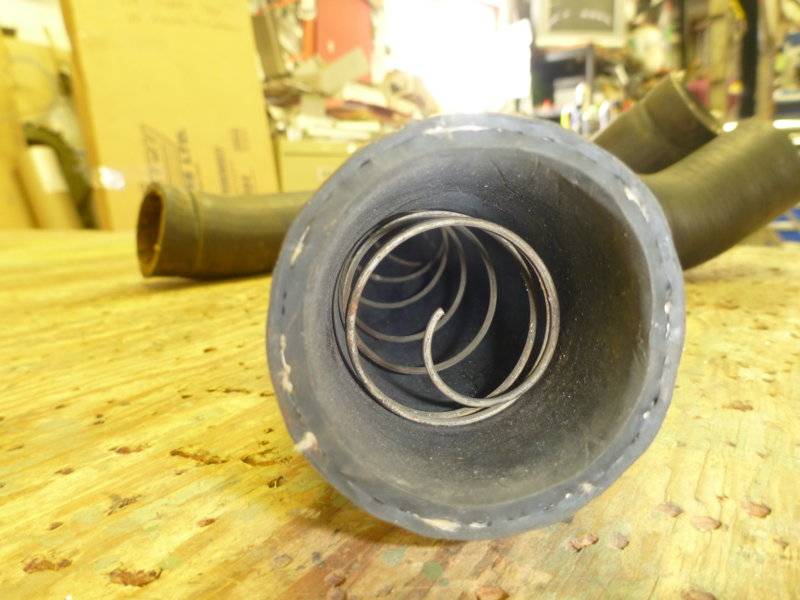

As noted, spring in lower rad hose only to keep it from sucking flat. I was lucky and my 30+ year old spring was still in perfect condition and I swapped it into the new hose..

Thanks guys. Sounds like I probably do have a spring in the lower hose. Will have to check it out tonight after work.

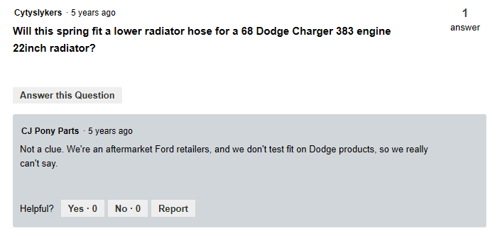

So was looking online last night and amazed that seems no one sells the lower radiator spring. Where do you guys get yours if it's missing?
