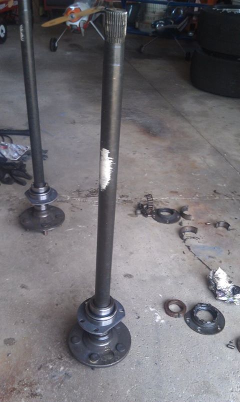

I took my axles out today. Both of the bearings are shot. I have read about the green bearings which I plan to use but have a couple of questions. The old bearings and the stop ring have to come off. Do the new bearings come with the stop ring? The area that the bearing rides on is not in the best shape, has grooves etc. Does this matter or can I put the new bearings in there the way they are? Also when I have new bearings pushed on should replace the inner seal? It is in good shape and my understanding is that it really is not needed with the new green bearings. Any helpful suggestions would be appreciated. Thanks

Thanks for the replies. Meep the outer rings are very loose and have no grease at all and yes they made plenty of noise. This is a car that I am restoring and has been off the road for 15 years. Maybe I should just repack them and reinstall and see how it sounds. I assumed that the bearings were shot because they were so loose. I am not sure how to adjust them. If I put new ones in I really don't care which bearings I use. This car will not be driven much so I thought that the green bearings would be easier to deal with. Thanks

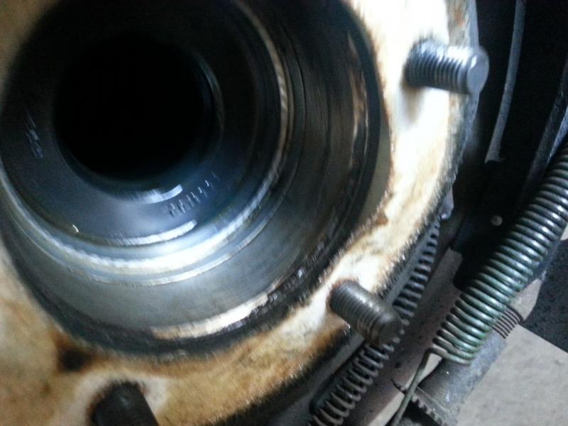

Super bee 1 bearings.jpgSuper bee bearings.jpgThis is what is in there.

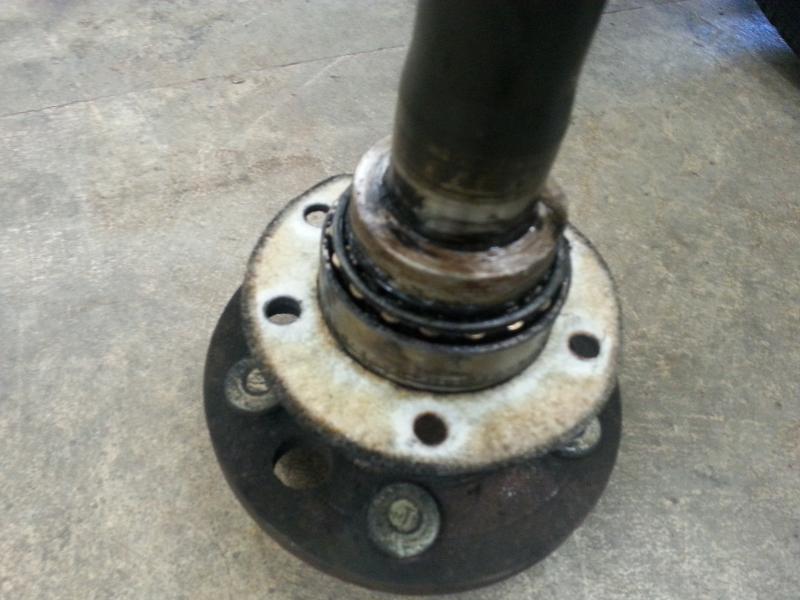

I just swapped mine out for the Green type. I bought the kit from Summit Racing, and it included the inner seals along with the retainer rings.
It was an easy procedure,,, I just cut into the original retainer rings with a cut off wheel, split them with a chizel and hammer, did the same for the bearing itself, cleaned everything up on the axle, tossed the adjuster and retainer plates off to the side, and reassembled using the new retainer plates, bearings and retainer rings..... A simple bottle jack press is what I used to press the new parts onto the axle..... The whole thing took a few hours to do!
