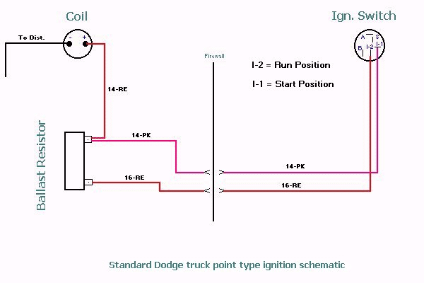

Not to bad really. Take the elct harness off, Ensure the IGN wires w 1 and 2 wires work, then 12VDC to the pos side of the coil and the ground lead from the dist to the neg side of the coil. Ballast resistor should be.5=-.6 warm.

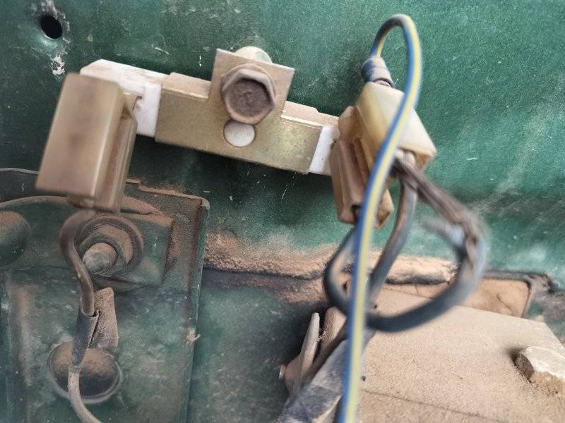

Thank you for the diagram. This is what my current wiring looks like.(Yes I know it needs to be replaced, but it is holding current.)
Do I need to add a ballast with four terminals? Currently if the control module is not plugged in the coil gets essentially full voltage.

Understand that a POINTS ignition system, as the diagram Halifaxshops posted previously is different than an electronic ignition system as illustrated in the link I sent earlier showing how the Mopar electronic system works.
In a points system, battery voltage comes from ignition key switch. It is fed to one side of the ballast resistor. in the "cranking" position, the ignition switch electrically bypasses the resistor to feed full battery voltage to one side of the coil. I the "run" position, the resistor is in series with the ignition switch 12 V. and coil feeding a slightly lower voltage to the coil. The other terminal of the coil goes to the points in a "points distributor" to complete the circuit to ground. The cam in the distributor opens and closes the points turning the voltage to the coil on and off. Points closed energizes the coil, points open de-energizes the coil and creates the spark that gets steered to the proper spark plugs via the rotor in distributor cap.

Given the current wiring setup, I am unclear what modifications are needed to properly use a points-style distributor.
I understand that the wire from the points distributor connects to the negative terminal of the coil, which is straightforward.
My main concern is how to integrate the ballast resistor.

Bottom line is that If you want to convert to a points type system, first thing you need to do is get a points type distributor that's correct for your engine size. That's not what you say you now have. From there, if you follow the previous thread posted by Halifaxshops, that's a basic wiring diagram for a points type system. You will need to know the coil you will be using to be sure you have the correct ohm value ballast resistor. The value is specific to the type of coil being used. Of course you will also need to reset your ignition timing as part of the process which in it self is a whole related but different topic.
