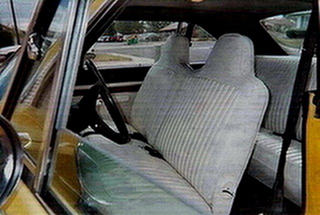

Legendary Auto Interiors sells it, along with all of the other items that you will need to rebuild your seats. I used it on the front and rear seats when we restored my son's 72 Dart Swinger's interior and I will use it on my rear seat in my 66 Coronet 500 when I start it's interior restoration soon. It's a very high quality closed cell foam and I've been very happy with it. It's 2" thick and you can buy it in various lengths.

1972 Dart Swinger- restored with BEAUTIFUL Legendary Auto Interior products! .jpg
