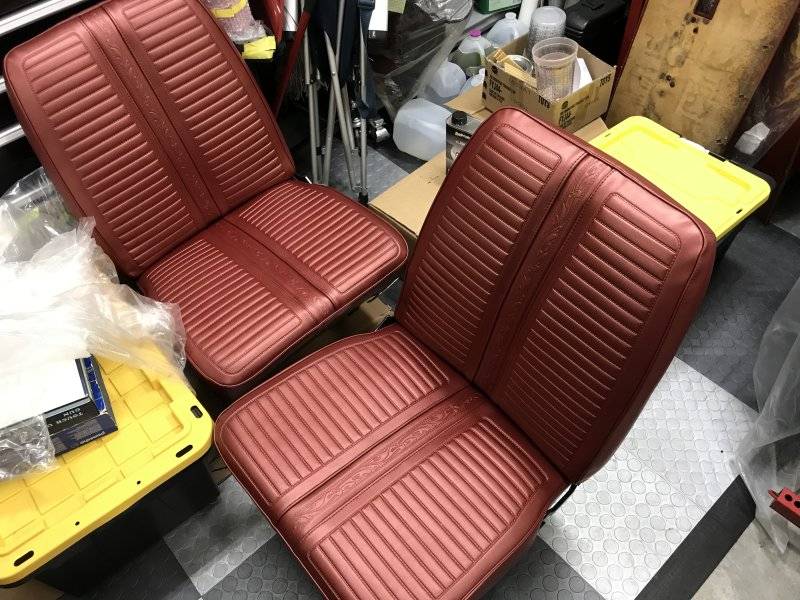

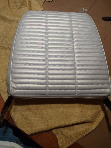

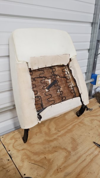

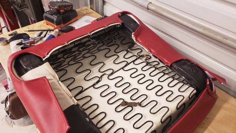

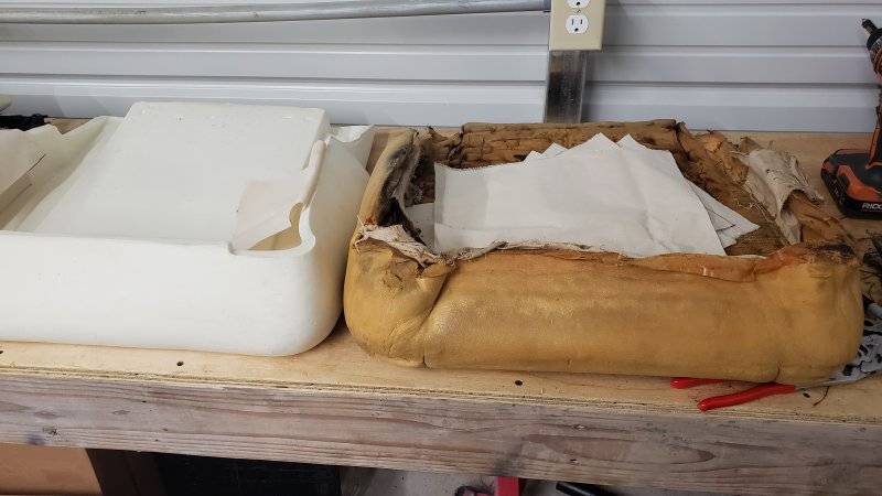

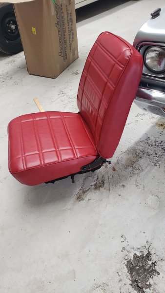

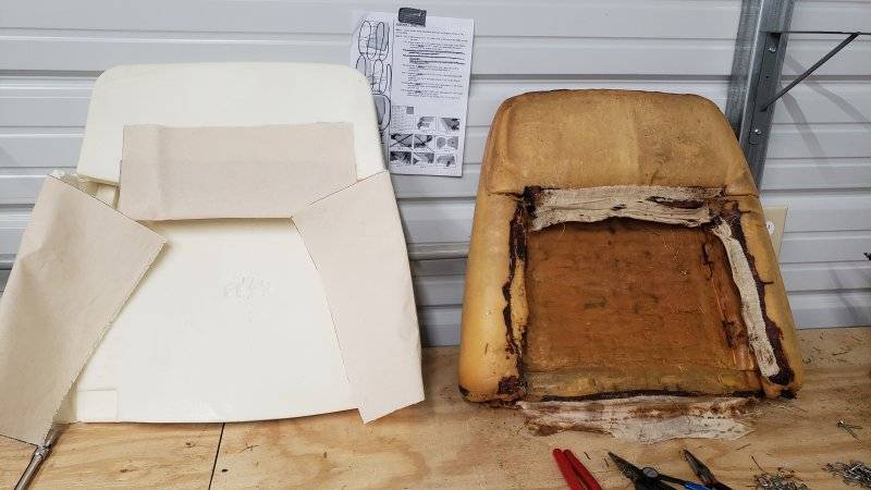

Did mine front buckets about 1.5 years ago. Ordered from legendary, took 8-9 months to get them. I also ordered foam and the installation kit. I watched the legendary videos and a couple YouTube also. I took lots of pictures while taking them apart. A couple things: I switched the carpet to black and had some trouble getting some for the bottom of the doors because I didn’t order everything together. When I got the seat foam there was a bunch of scrap foam with them. Don’t throw it away. I should have put some extra in the edge of the insert area to fill it out more. They are fine the way they are but could have been just a little bit better. But my rear seats and door cards are all original and look decent. It’s just a driver. Oh and if you need seat backs order them at the same time as the cover too.
They look great.

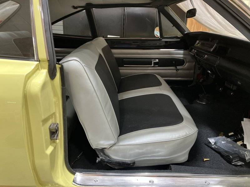

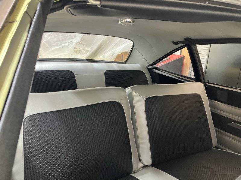

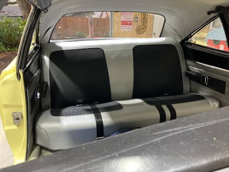

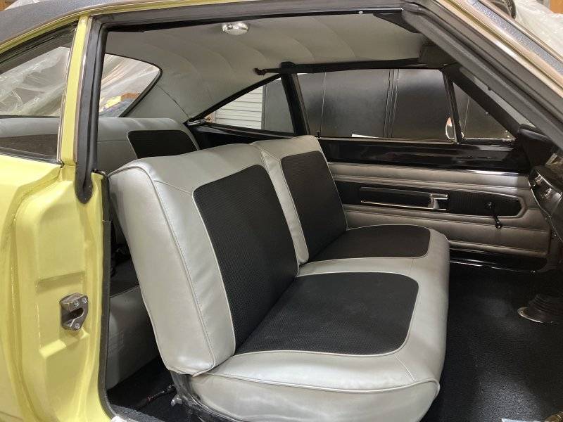

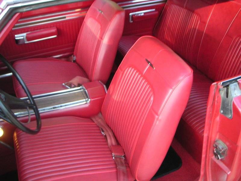

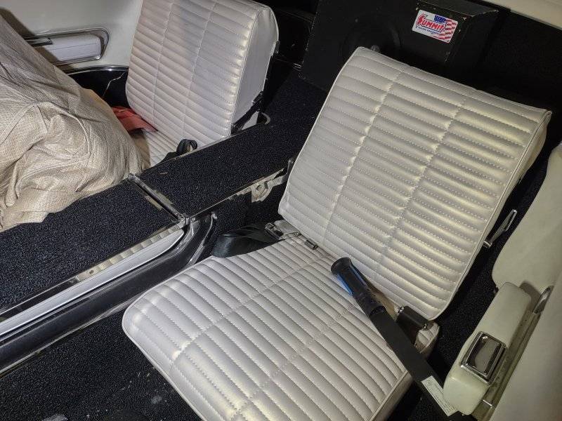

I did the front and rear seats in my 64 Valiant convertible and they are perfect. I get compliments all the time.

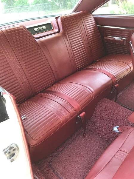

I ordered a complete headliner to carpet interior from Legendary in January for my 69 Charger. Everything! (20% off sale) If you place the order at a big Mopar show when they are there, you get 20% discount. Some of the in stock items arrived right away with other things staggered over 5 shipments. The seat covers were last because they are not usually stocked but are made after they receive the order. Even so I think it only took 8 weeks to arrive.

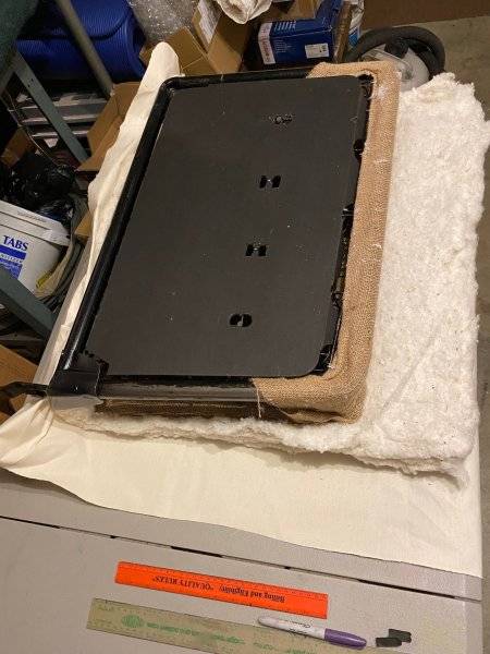

One tip I got from a video on covering bucket seats. Put a yard-sized garbage bag over the seat, then pull the bag over it. The new cover will then slip on quite easily.
