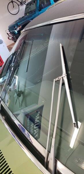

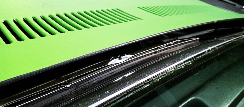

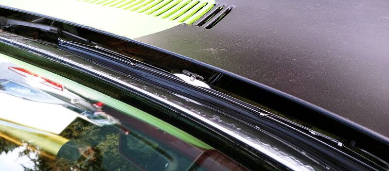

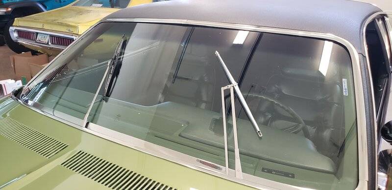

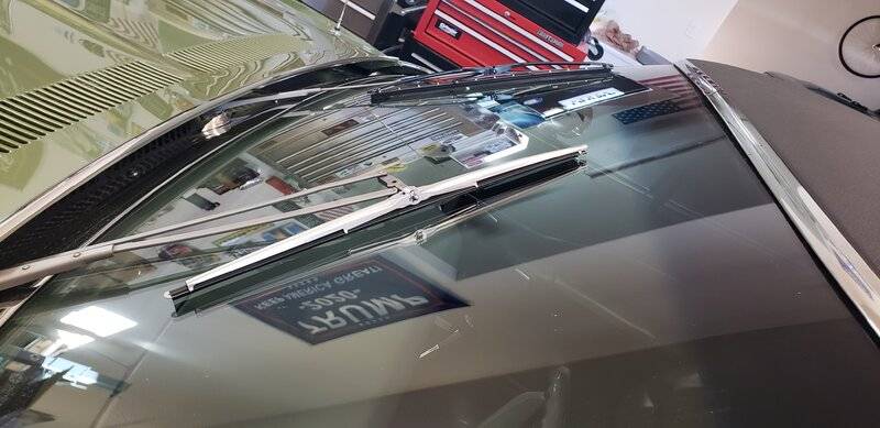

And, as everyone could check on the pic posted by 72RoadrunnerGTX, the look and fitment is perfect and I can testify they wipe perfectly on my car being a driver on a tropical country.

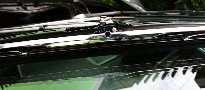

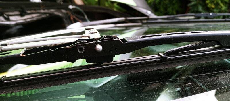

The design of these Trico produces the perfect tension over all the rubber fill lenght, way better than the Ancos. Also follow better the windshield curve.

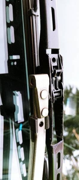

The installation over the bayonet end is snap on and actually more firm than Ancos, without any play on pin which Ancos get. No need for release tabs since is spring loaded. Sure is kinda scary because you can feel they could jump out easily while wiping over the glass but so far so good it hasn't happened to me yet.

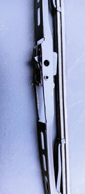

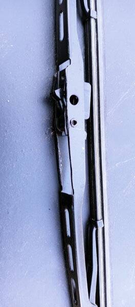

However I can't recall mines being painted, but with the original SS finish like should be!

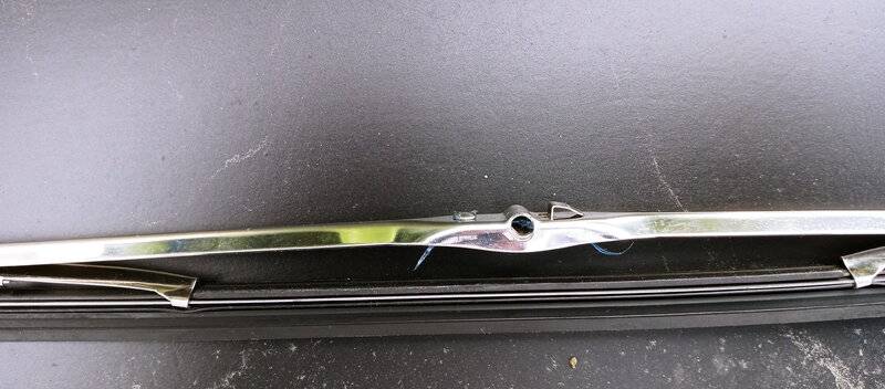

Thank you Nacho I really appreciate your help and knowledge. The pictures of my wiper blades were still wrapped and they have a chrome finish and looks like the same attachment that will work.
