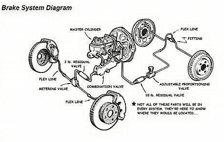

My understanding is to mount/install the residual valve then the proportioning valve as shown below.

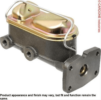

it's going to depend on what master cylinder you use. Most OEM style have the residual valve built in but an after market MC such as a Wilwood, will not
i confirmed that the
Cardone Industries 131571 does not have a residual valve. I assume residual valve could be mounted in a vertical position as well being that its just a simple check valve?
Better recheck. Thats a production replacement for rear drum brakes and it should have the residual valve.
Cardone confirms all their master cylinders do not have residual valves.
Do you have one? If so, you can check by trying to insert a thin rod or use a straightened cotter pin in the front port hole. No valve the pin will go in deep, if it has one the pin will stop almost immediately as it is being blocked by the valve

Residual valves can be mounted in any direction. it doesn't matter if it's before or after an adjustable valve.
Their drawing is not correct, if you use a combination valve as shown you have no reason for residual or adjustable valves
Keep in mind the right stuff, MBM etc are only concerned with selling you parts whether you need them or not. I run drum brakes all the time without a residual valve and it is unnoticeable from when there was a valve in line. The only time a residual valve is mandatory is when the master is below the level of the brakes

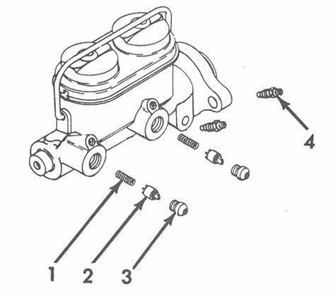

I believe in 1975 they stopped putting residual valves in the MC and started with expanders in the rear wheel cylinders. I have no residual valves in my MC and nothing inline and I have no trouble with braking. The Disc O Tech brake article references the lack of residual valves and expanders in the wheel cylinders.

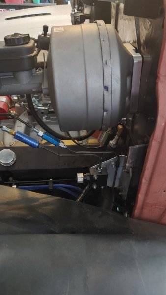

My m/c from Dr Diff does not have a residual pressure valve either. I spent a yr trying to figure out why it felt like air was getting in the system n requiring pumping periodically. Cass said to install a 10psi for the rear as close to the master cylinder as possible before my distribution block. I went ahead and installed a 10 psi for rear and 2 psi for front. Had a custom made line for both front n rear from m/c to distribution block w valves installed. Amazing difference!!! 15/16" bore manual brakes and they are easy n stop on a dime.
