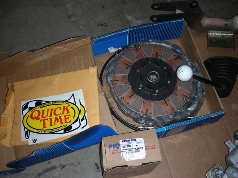

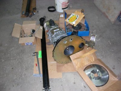

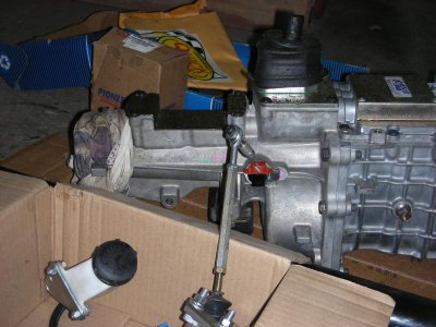

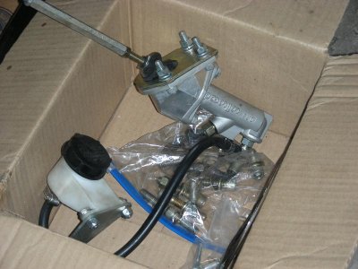

A huge thanks to Drew Williams for the great deal on the TKO 600 tranny kit, got it today and everything looks great. I figured the fact that he had a Dana rear might be the only hold back on getting this installed since I have a 8 3/4 but the local auto store sells a universal that has both cups making it a straight up swap:headbang:. So the plan is to have the auto out tomorrow night, install bellhousing and check alignment (Summit stocks offset dowels if it's not within specs), and get it wrapped up by Sunday. The weather here is crappy with nothing but rain so it's perfect timing to tackle this job. Can't wait
Forgot to mention he ended up using an 8 bolt crank so the flywheel and clutch are all still brand new :headbang: which really sweetens the deal. I thought these were more of a bolt in tranny but a quick look at the rear most shifter location shows how much Keisler milled out to clear the cross member. I really like the master cylinder setup too, it bolts right threw the original clutch linkage hole so that will be nice. He even sent all of the paper work which is great, Thanks a bunch
Amazing! Anxious to watch this happen and hear your thoughts! MANNN PEDAL TIIIIME (fer racin' obviously!!!)
SAAAAAAAAAWEET....you know what the manual guys say dont ya...."I LIKE TO DRIVE MY CARS" like goon said fer racin baby. lol you gonna love it.
I'm sure it will, can't wait!!!!! I've never owned (or driven) a V8 with a standard so I'm pretty anxious to bang some gears, my daily driver is a V6 standard and I love it even though it isn't anything to brag about so this outta be good. Last night went pretty well, got the 727 pulled (forgot how much stuff there was to unhook) and the flywheel and bell installed but since there was nobody to crank the motor while I watch the dial indicator that's all the further I could go. Picked up the universal and pilot bearing today although it's going to take some work. The pilot sold for this setup (can't get it by this weekend) is just a Ford pilot bearing from a Mustang fitted into a bushing so that it fits into the torque converter nose bore so I'll have to machine a bushing to install it (always something). Sunday is looking pretty iffy on finishing this and it might take till next weekend with the growing honey do list but I'll drive it before I park it for the winter.
MMMM new parts! :blob1: Looks good man! Thats exciting! I've never driven a V8 standard either! Manual transmissions are so much more fun! Definitely looking forward to see how this turns out, I wanna do something like this to my 71 Satellite which will be the next project.

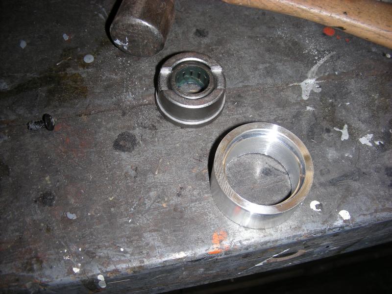

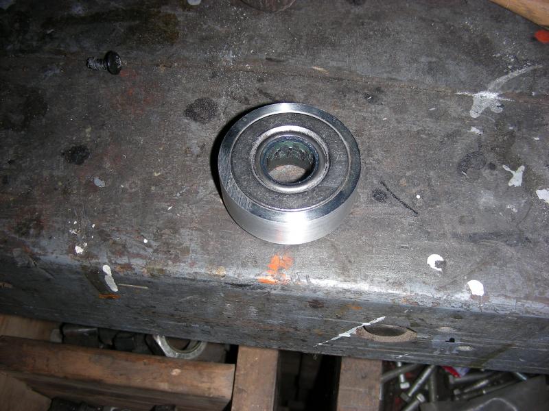

Had a little time today to tinker around and figured I'd get the pilot bushing taken care of so I would have it. I just took the Ford bearing and made an aluminum bushing for it to fit into and had the correct O.D to fit the crankshaft "man do I love that Monarch Lathe".

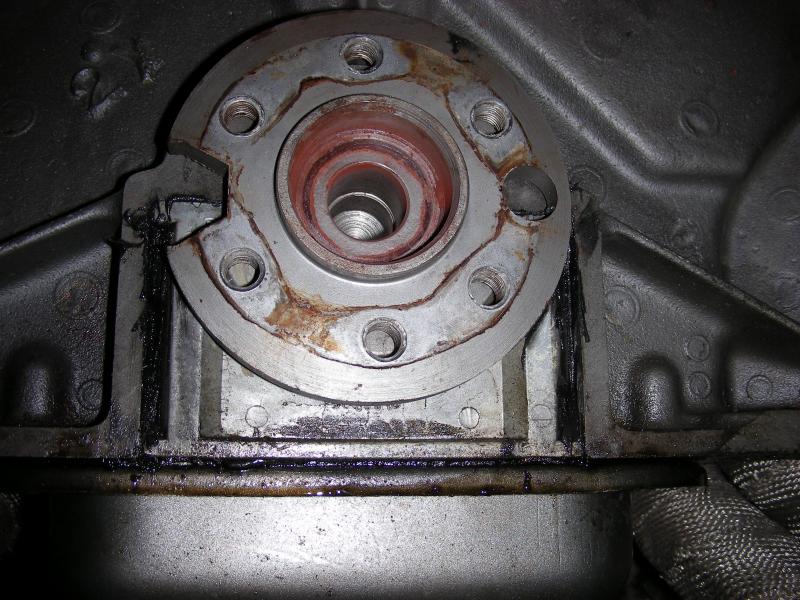

This was a pleasant sight, I've been concerned that I had a rear main leak but it's dry as a bone around the seal and looks to be just a pan gasket :hello2:.

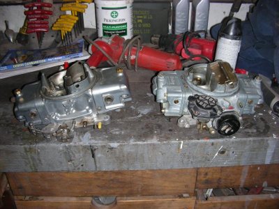

Here's the carb swap, out with the Holley Vac Sec and hello too the Demon DP. Here's a little something interesting I noticed about the jetting on these 2. I've had really good luck with Demons being really close right out of the box so I checked out the power valve and main and guess what???????? The Demon is set up almost identical to where I ended up on the Holley which was way off.

Like Goon says, that extra man pedal that's made fer racin is really going to put a smile on your face lol. I didn't see where you mentioned your tranny used a special pilot bushing. If not, the National FC-69907 is a needle bearing that works great with no modifications - although you already have it taken care of.

Yes it takes a special pilot bearing, the tranny is basically a Ford Mustang tranny that Tremec has upgraded for more torque handling capabilities and higher rpm shifts. The input shaft is a bit shorter meaning it engages the pilot bearing where the converter would normally seat (the big bore)
instead of the smaller bore originally for the pilot bearing. Of coarse that means it's a Mustang diameter as well so you just need a Mustang pilot bearing bushed to fit the bigger converter bore. American Powertrain wants $60.00 for this bearing that I have just a few bucks in.
