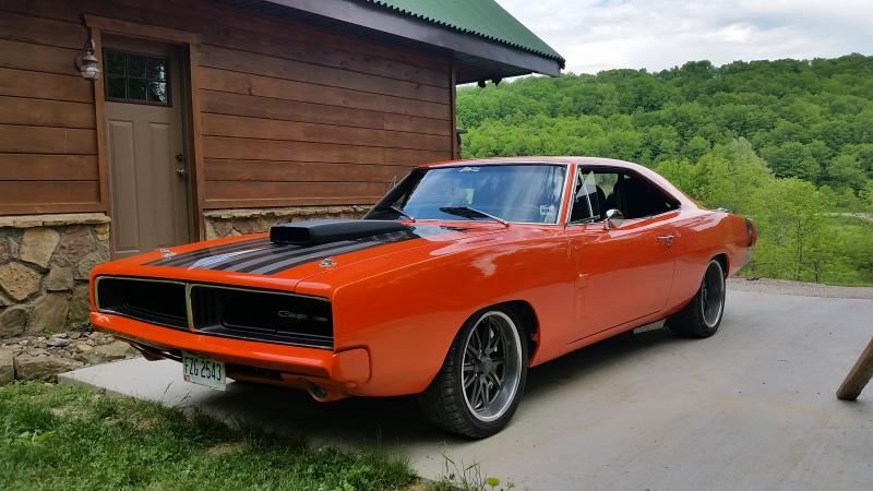

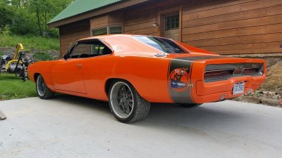

Well today I played with the suspension a bit and am kinda happy but not completely. I took the springs to a local spring shop to get them evened out since one side was an 1" higher and get them de-arched for an additional 1" drop at the same time. After bolting them on it looked mostly unchanged but mostly my fault though, for one I torqued everything unloaded and failed to think about the effect that the changes would make on the front end. I measured the front, re-leveled it and loosened all of the leaf bolts bouncing it to get it settled in and it now sits perfectly level all the way around without any goofy blocks but is still about an 1" higher than I wanted. I'll talk to the shop about getting that additional 1" but for now it's going back together, It's been 3 weeks without a Charger and that ain't cool at all!
your lil puppy is cool as hell. he wont stay that way for long. the car looks fantastic again. you never know anything happened to it. everything is coming together now for ya. very nice.
Even though I was calling it done last year it's really feeling done now, I've always been on the fence with the stance, had a handful of unattractive do dads, the jacked up leaf springs and just the lack of any call outs or any other emblems always had me feeling like it wasn't done. Benno helped me with the stance providing the ride height from his seriously sweet Charger, I got a new gas cap, new Charger emblem for the grill, custom call outs for the scoop and got the leafs all straightened out. Pretty happy

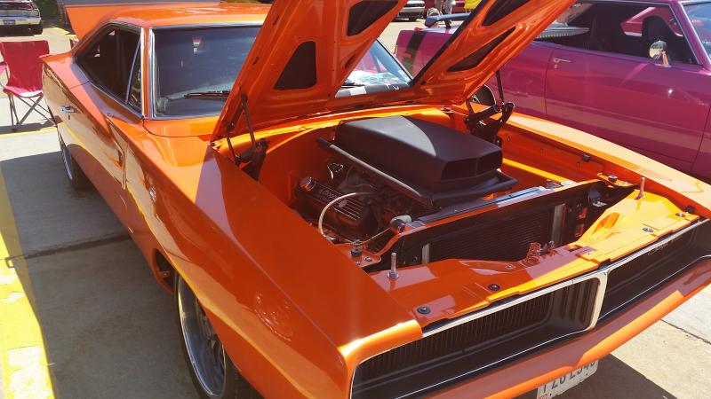

Before there's a mutiny . . . here's a pic that 747 Mopar TXT'd to me from Summit . . .
Enjoy ! ! ! !

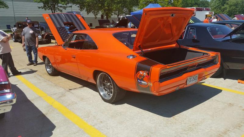

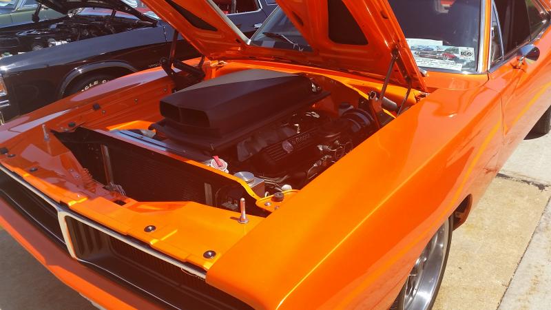

Thanks Kahn, I just got back from the show and have to turn around and leave again (IN THE CHARGER OF COARSE) so no time to post again. I've got a few already and will get more, I promise I'll post some good pics tonight. 3 weeks without the car............... I'll be driving it ALL DAY LONG!
A huge THANK YOU to Benno, leaf springs can't exactly be adjusted around until your happy so getting that critical piece of info off of someone who already nailed it was very important to know how much to have the leaves de-arched. I hate copying anything but my car measures almost spot on to his now haha, what can I say I love it!
Here's a few pics I promised, I think getting the rubber partially into the wells was the missing touch (me likey now). Put a few hundred miles on it today with no issues other than a small vibration still exist that I didn't notice until I got some freeway time but not nearly what it was but it's still there. Don't no where else to look to be honest, I'm stumped! I picked up some axle shims while I was at Summit, since it's so quick and easy I'll shim it to an absolute perfect match and if it still does it I can at least eliminate that which I'm fairly certain it isn't anyways.
