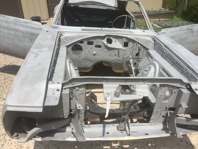

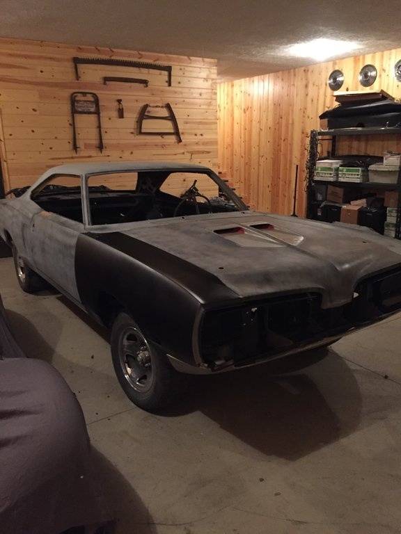

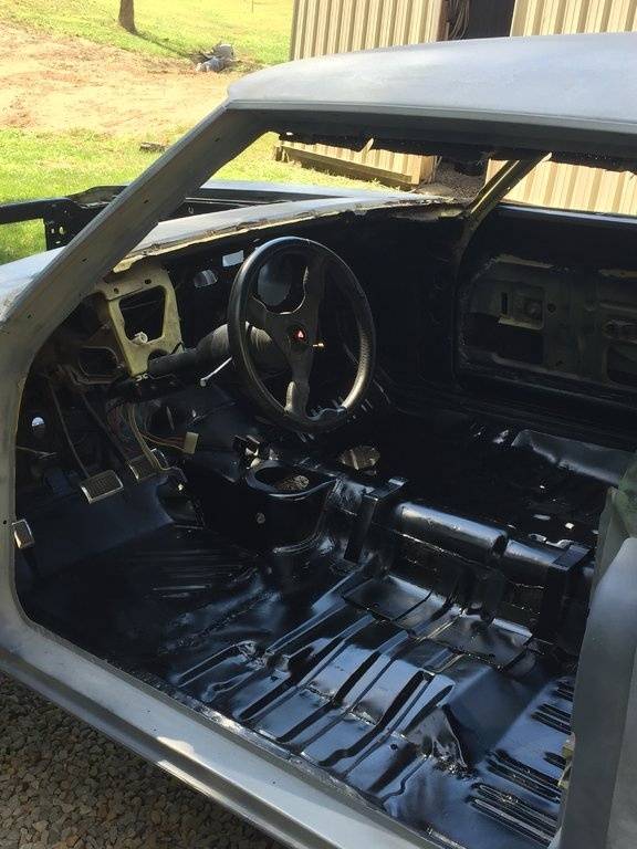

my 70 bee is going to paint in 2 weeks! It's been a long but enjoyable road.
Nice! Looks great! Keep the pics coming.

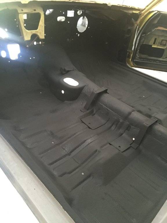

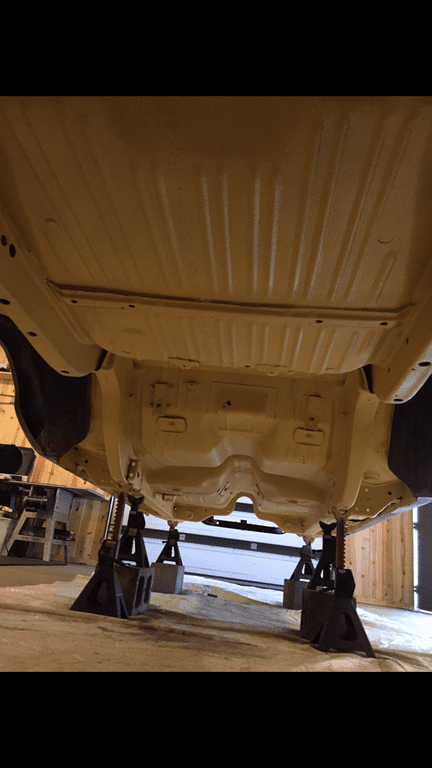

It spent most of its life as a drag car. That fortunately saved a lot of the panels. It is not going to be a concourse car when it's done. I'm going to build it to drive. I will put a black vinyl top on it which it didn't have. The original engine is long gone so I plan to have fun building one for it. I have a 70 standard bore 440 block. Probably going for a .540 cam. I lizard skinned the inside of the doors, underside of the roof, firewall and floors (not the trunk) with both ceramic coating and sound deadener. I will add hushmat after paint. I thought long and hard about the underside. I decided to blast and spray the tintable raptor liner on the underside for durability and ease of cleaning. A lot of diehard restoration guys will give me hell over it but bottom line is that it is mine and I intend to drive it! ill post a shot of the underside when I can get it to load. All bolt holes were sealed prior to shooting and all old seam dealer was removed and replaced prior to applying. Torsion bars and k member were removed... gas tank was out. I did it as right as I could

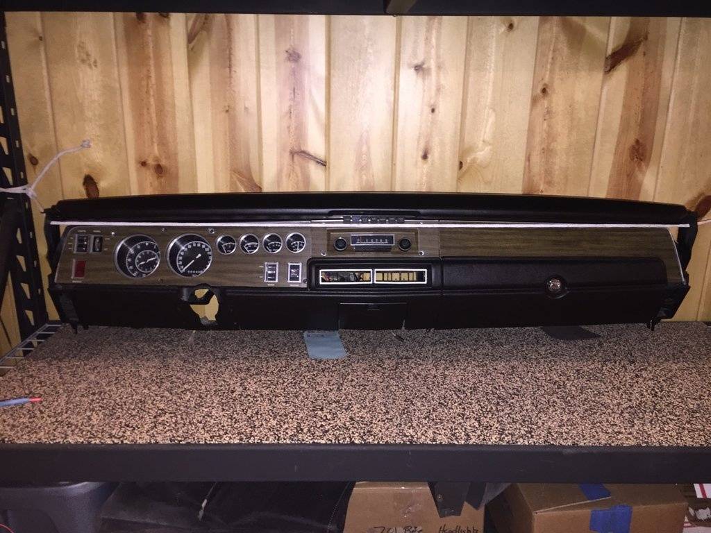

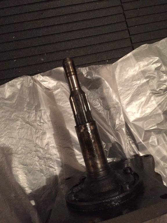

Dash is done... ready to install Also. I have a 18 spline transmission for it as well.

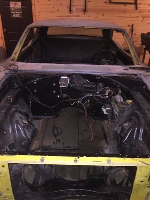

Car is originally an auto car but has been changed to 4 speed. I'm restoring it to be my dream car!!

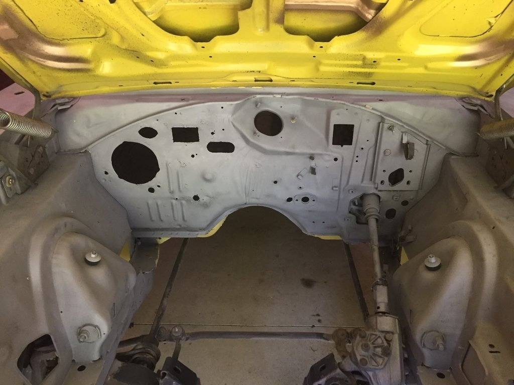

No but the guy I bought it from did. Same options but very hacked up.. cut up floor, cut up hood, welded up all the opening in the firewall, racing buckets. The headliner was still original and has one mouse hole above the drivers fender. This is a St. Louis car.

All holes had steel plates welded around the hole openings and were filled with fiberglass. A lot of welding and patching to get it back to this....
