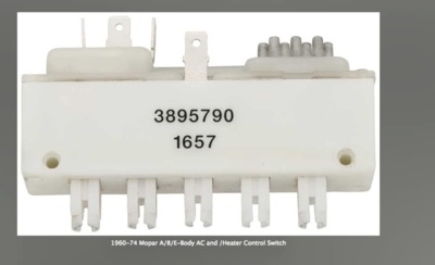

I just purchased a control switch on line for my '65 A Body (Barracuda Formula S). I have not seen it up close yet. It fits a few other models as listed.
website:https://www.oerparts.com/product/3895790.html

Awesome!! I would think that would be a critical part and it says it fits 65-72 BBodies. Thanks Dibbons! By the way,... I have that model you are using for your avatar in my hobby room!
