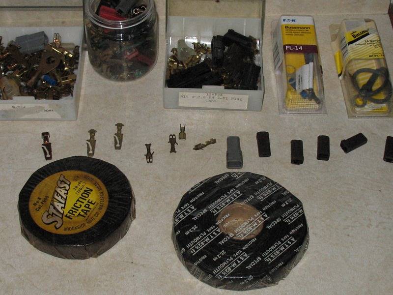

If you’re needing the lock in spade terminals, Napa has them. Part # male - 725147, female - 725145. About any hardware store would have cloth tape, but the non adhesive type can be bought through Ron Francis or Painless.
On the harnesses that were not offered, for my '63, I used Orangewipes, to remove some of the aging on the wires. All the metal connectors, sockets, junctions, even the bulkhead connector, I soaked in Evaporust, till it cleaned up, rinsed in water, then Isopropal Alcohol, to remove the moisture. Where it was needed, I touched the bare spots with paint, or RPM, to keep it looking decent.

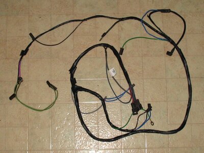

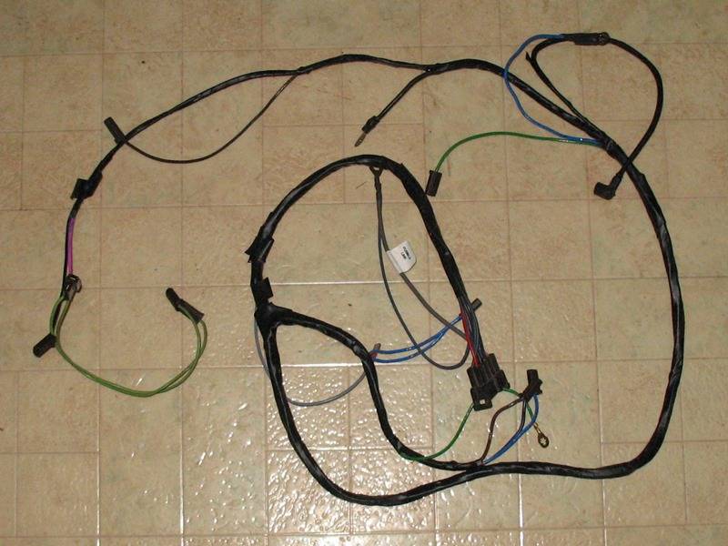

Your initial post is pretty vague, at least to me, as restoration could mean one terminal all the way to complete replacement. Also which harness. Engine, dash, light, all? I have handmade my own engine and battery harnesses. I have acquired many terminals, plugs, tape and wire over the years at various estate and flea market sales. It is because of this stock of stuff I have on the shelf that I was even able to attempt making these harnesses. I would never to claim they are 100% the same as OEM, but I would bet 99 out of 100 people seeing them on a car would have no idea I made them.
