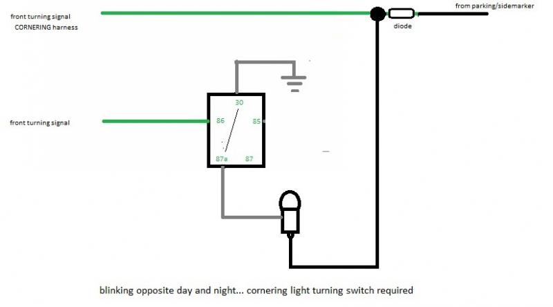

Yes I know, but need to source it right, because if not, will light up ALLWAYS. Need to link the sidemarker to a HOT source on positive side JUST when turning lights are on to keep the hot fixed while lever is on position, then break ground will work to blink off opposite.
The problem is, the flasher gets the source straight from batt/acc ( pre turning switch )... then the turning switch gets the source to spread up ALREADY blinking from flasher. The flasher works just AFTER the load is present, selected by the turning switch
So we can't get the Hot source from flasher ( after or before ), neither from turning swith. Not at least on an easy way
THIS IS THE MOMENT the cornering light switch pieces comes into play!!! to feed the hot source JUST when turning lever switch is activated
this is the only way I can find to make them work opposite on BOTH stances, day at night... set up for EACH corner
pretty much easier than anything, but requiere this turning swicth ( if this switch works as I suspect ).
then two extra wires to each corner, one relay, one diode and couple of splices
I never have tested how the cornering lights harness works, but I guess muste be one hot input from batt/acc and two outputs one to each side, hence the 3 added wires
DIAGRAM CORRECTED, diode must be on the other side of the splice, to save the FULL parking system to be sourced from cornering light system when activated... the other way doesn't matter since power doesn't run anywhere important, except a hot source which will be already existant anyway...
Previous diagram was to cut the power to cornering light harness when parkings are on ( which actually doesn't matter ) but wouldn't save to feed the parking lights when cornering system are on
