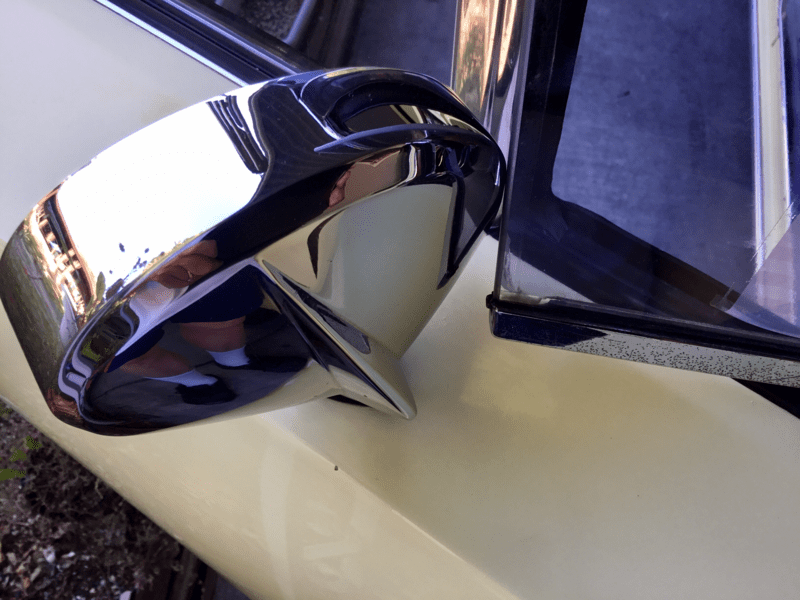

My 69 has them mirror imaged on the other door and with the wedge it clears the vent window fine.
I just today sent this pic to kiwi to answer the same question,clears wing window
