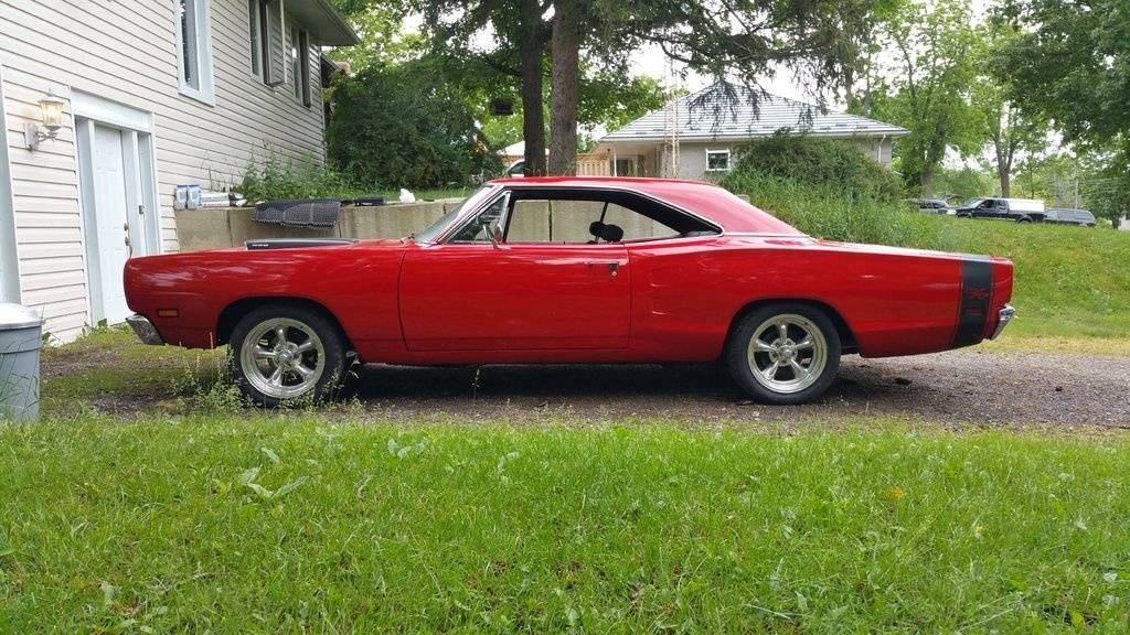

I ended up going on the safe side with the 17's and go 275/40r17's for the rear. I don't have a sure grip and I have highway gears, so I'm not wasting my money on the drag radials yet. But I did mount a set of junk 275/60r15's on the 15x8's and the do clear. I'm hoping to get the 17's tomorrow, but I need to get new lug nut's before I can mount them.
Really happy with the way it turned out.
