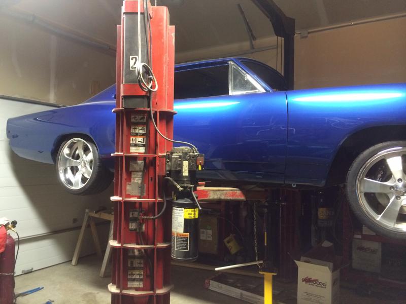

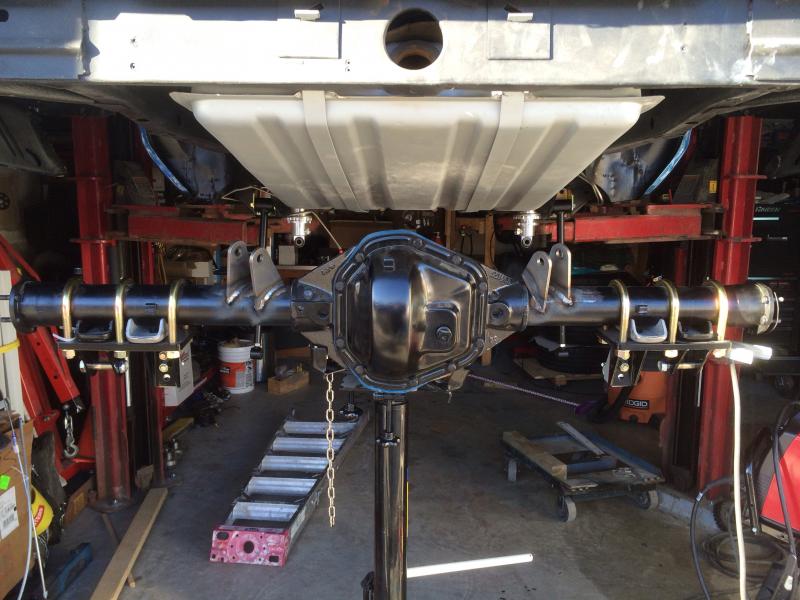

Nice day in Calgary. My mom took my 1 boy to my sisters and wifey took the baby to the mall. Worked with my dad on the Dodge. image.jpgimage.jpgimage.jpg

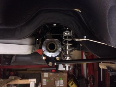

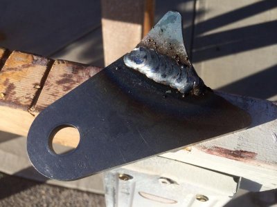

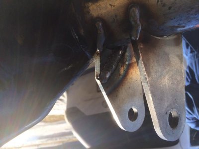

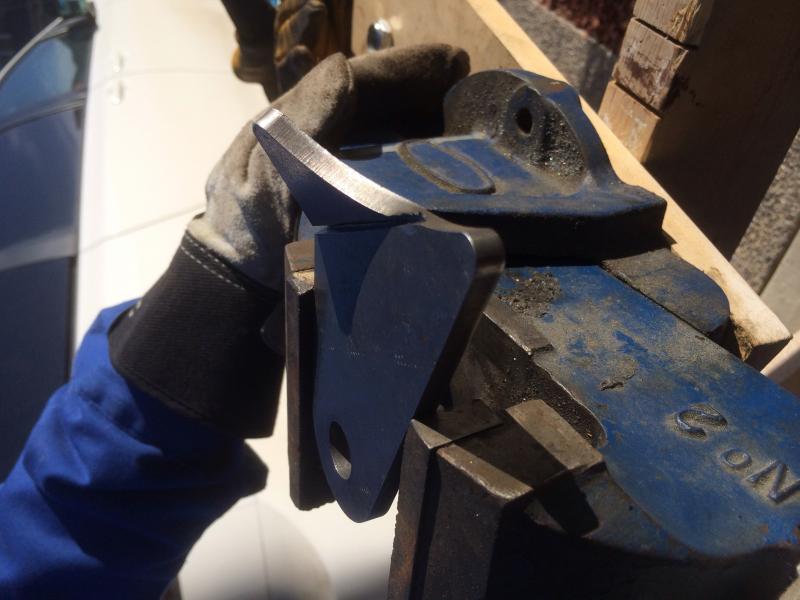

Bent the tab that was interfering with the centre section. Welded up the seam... Voila... I have a 4 link. I have my suspension almost complete. I have to make a few tabs to hold the brake lines and find a shorter breather vent. image.jpgimage.jpgimage.jpg
Sorry. For some reason the pics flip

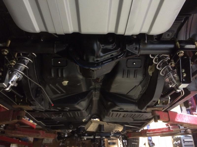

Getting there. I only get 1/2 hr after work before I have to go inside and take care of the kids.
