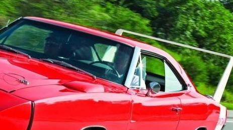

The aerodynamics team that built the 69 Charger 500 and Daytona knew about this area.
That is part of it but there is more.

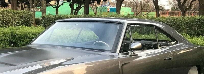

Custom builds sometimes include shaving the rain gutters and other tricks:
There is some loss of the old car appearance here so it will not appeal to everyone.

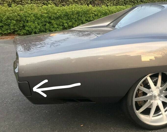

The tight fitting custom bumper is a great look to me, though I'd prefer to see chrome.

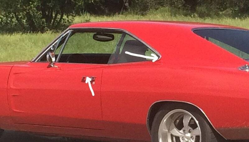

The outer door handles stand off the body.
That surely induces some turbulence compared to these:
I'm not changing those either.

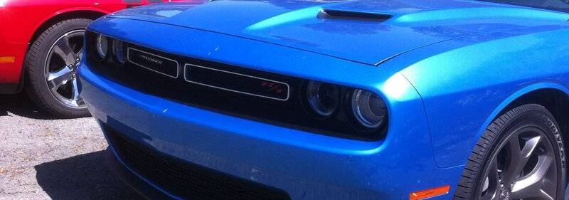

The inset grille:

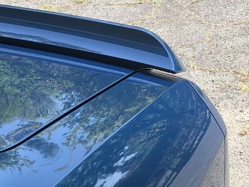

The spoiler is bolted to the trunk lid but does have gaps between it and the quarters.
