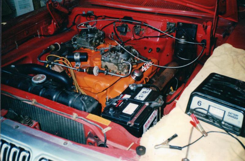

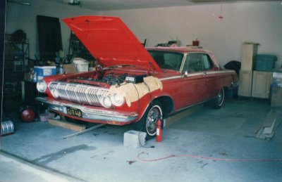

This is how the car was when we saw it in NC

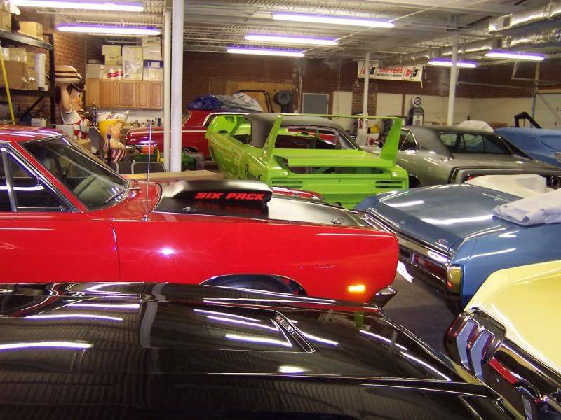

more views of the previous owner's garages :)

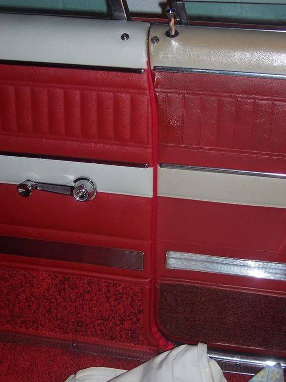

Car was again out of commission for the autum/winter/spring of 07/08 while we tidied up the interior, which still had most of its original parts. The seat vinyl wasnt in bad shape for its age, but the foam crumbled everytime you sat on the front seats, leaving a pile of dust on the carpet. The stitching on the original vinyl looked a bit fragile, so we decided to go with new Legendary covers & foam, with matching door panels from SMS. Shame the old stuff had to go, but we're pleased with the results. Despite the seats having the wrong colour stitching (red instead or white) and being a bit tight in the front & loose in the back :rolleyes:
Showing old & new door panels..

Nice collection of cars! Nice shop too!!

Sorry Brendon, just re-read your pm to me, where you said you'd seen the car in Pinehurst when you lived there. I spose those pics were from back then in Pinehurst?
Doesnt look a lot different to when we first saw it in 2004 in Greensboro!
