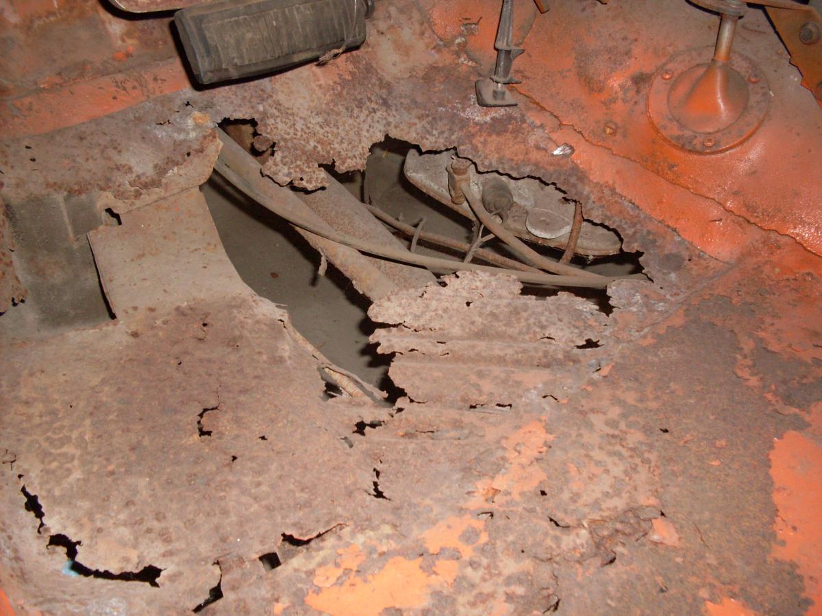

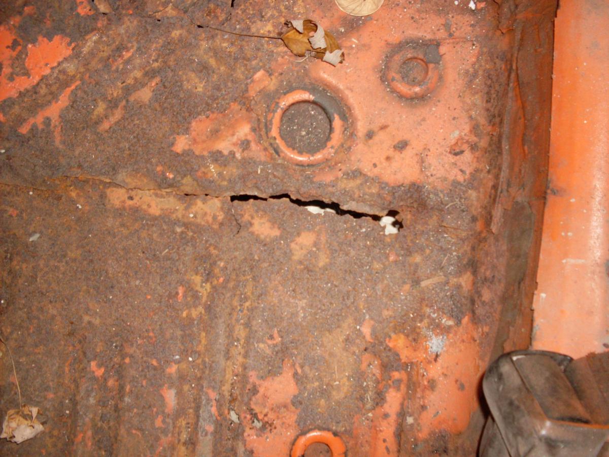

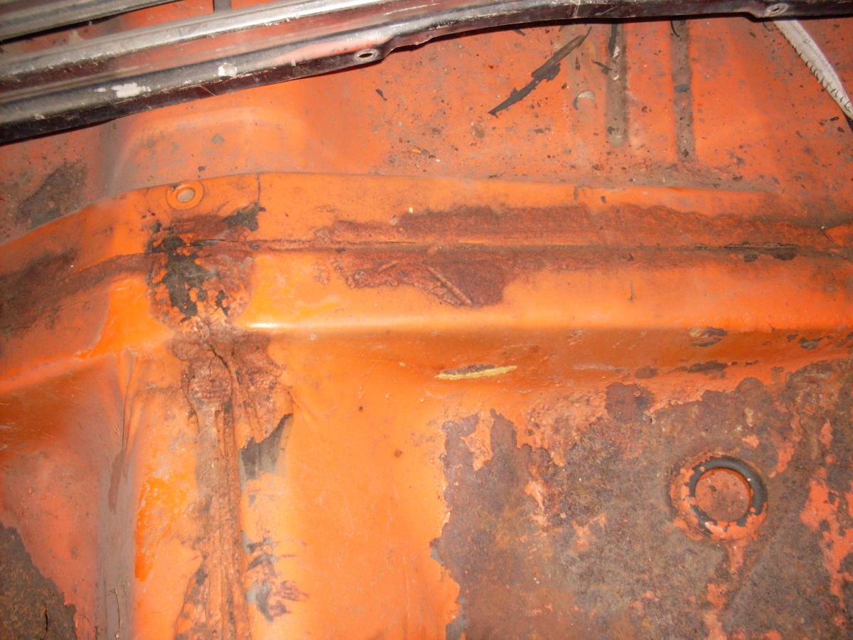

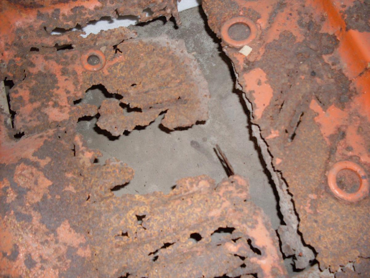

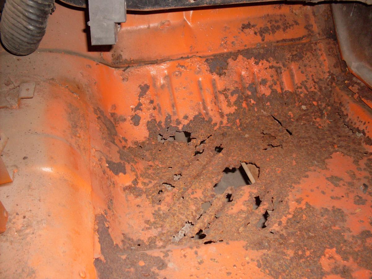

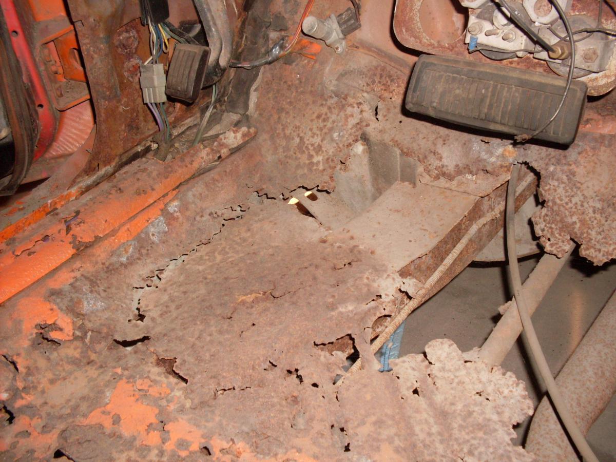

Yeah, Roadrunnerman, your best $$ you can spend initially is getting this car Media Blasted. Sure, this is my profession, and sure I've done the DIY thing many many times mainly due to stubborness, and pride to 'do it yourself', but, when adding it all up, I would not do the DIY route again; it's a longer time frame, not really as well-done as a pro, and, it costs equal if not more than paying your Media Blaster 1500-2000 bucks to get it done correctly. Once Media Blasted, then you can cut out the old metal, you can see what you have...trust me, patience is good and desire is good, but coupling that to a wire wheel brush is (what we used to say in the Army) 'A No-Go at this station'. Wire wheels will NEVER get it as clean, as fast as a media blaster can. Go check out my site, my videos, and facebook page drbplasticmediablasting to see this process. Oh yeah, when you run into Bondo, even the Media Blaster has issues getting it off, but, far easier than any other process out there.
Your car can be brought back; it's rare enough and worth enough in the market, and to you to take the steps to make it happen. AMD metal is good, very good stuff. However, putting new metal over old ain't too good. Yeah, Media Blasting is expensive, but, the end-result is really worth it.
