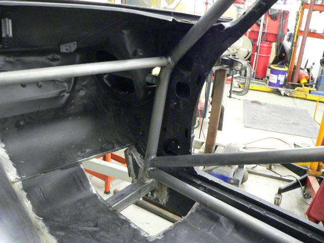

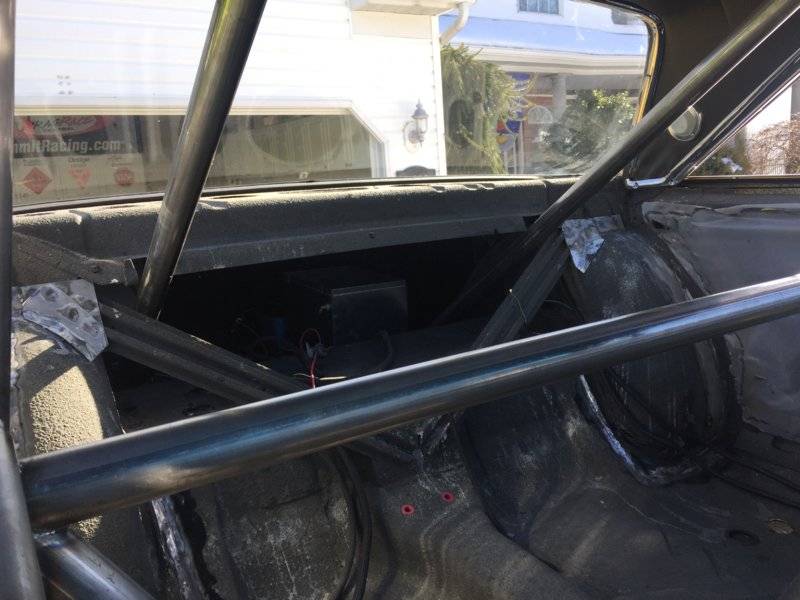

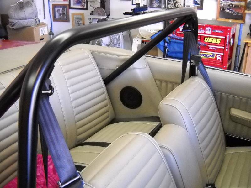

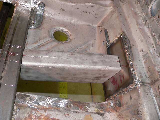

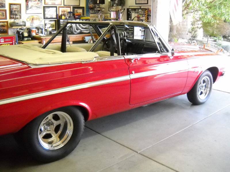

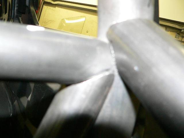

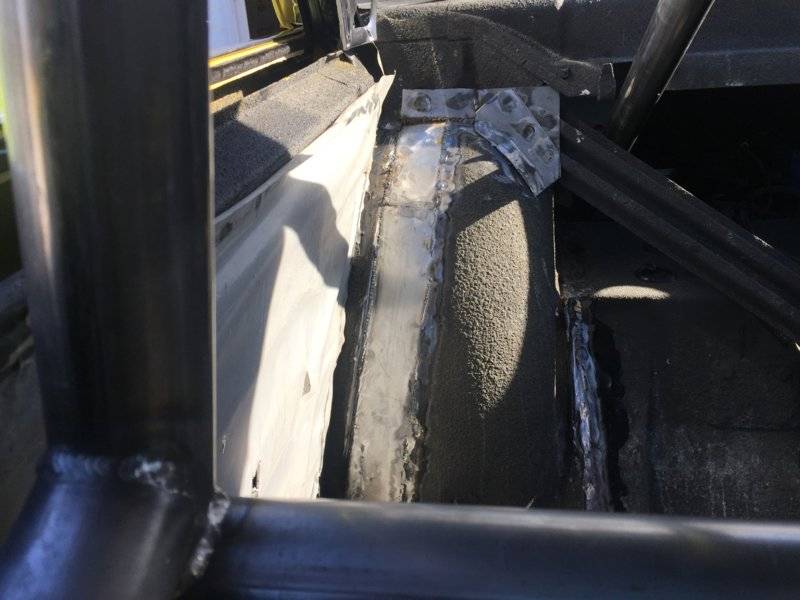

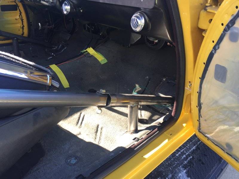

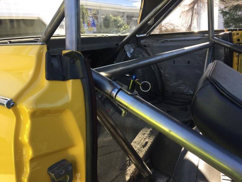

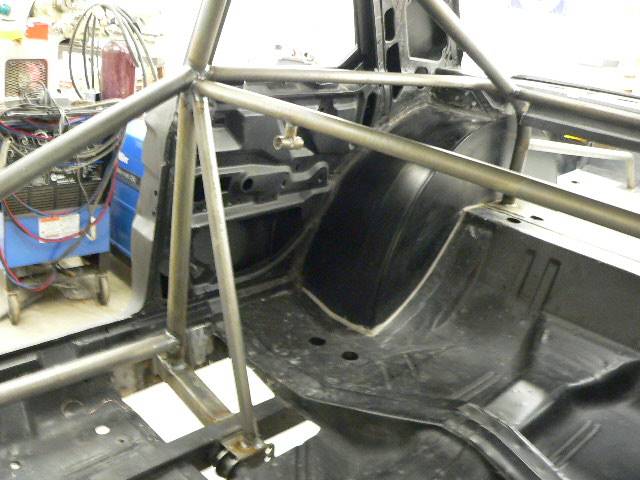

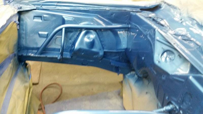

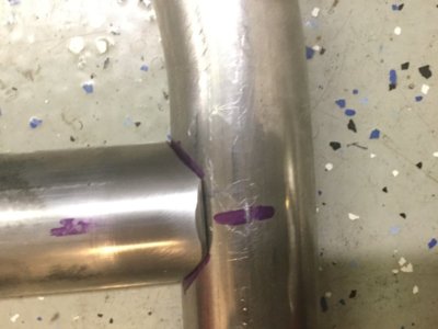

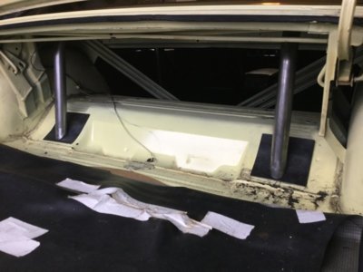

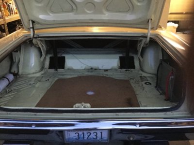

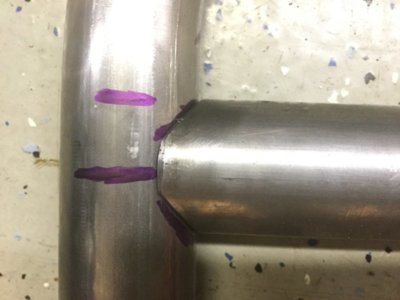

I built mine out of Moly .083" (some bars can be as thin as .050") for weight savings. Moly must be Tig welded. DOM .120" is lighter than the standard ELW .134". Both can be mig welded. But DOM costs nearly the same as moly. I didn't use floor plates but plated the inside of the rocker. Then ran out riggers between the subframe connector and this plate. By doing it this way you can tack weld everything first. Then cut the out rigger tacks and drop the entire cage down to access the upper bars. Cutting the floor out around the outrigger and reinstalling the piece after is much easier.Brake line was used to make templates. Most tube were made long and then snuck up on the fit. Obviously a roll bar would just be less tubes. My sons car and my street car have roll bars built similar to this. The exception is the rear bars are up ar the roof as both have back seats.

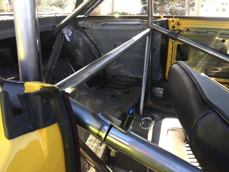

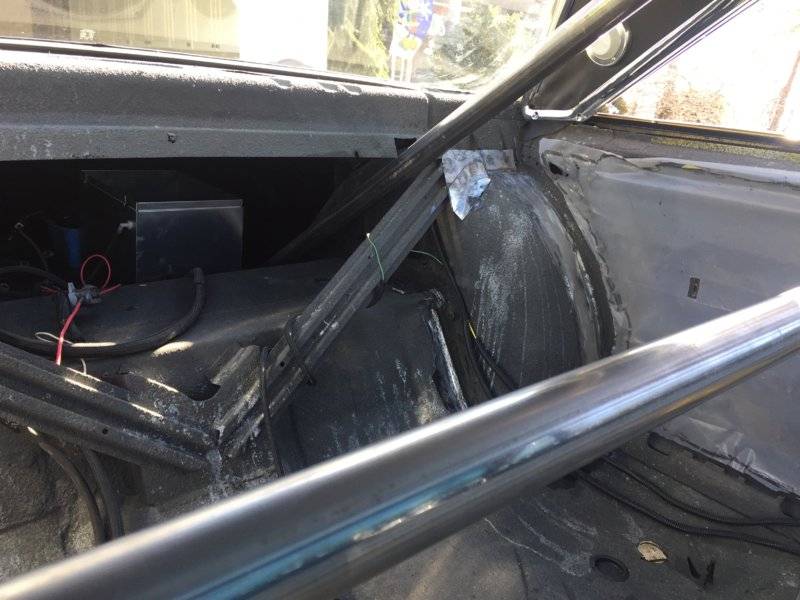

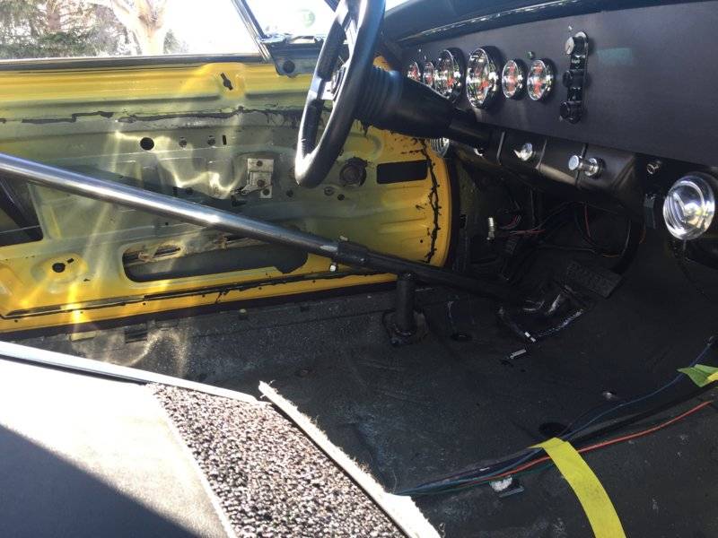

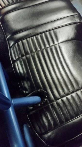

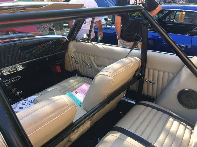

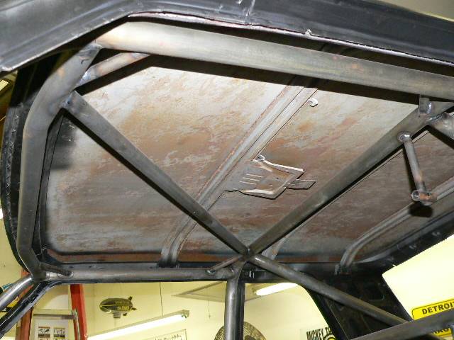

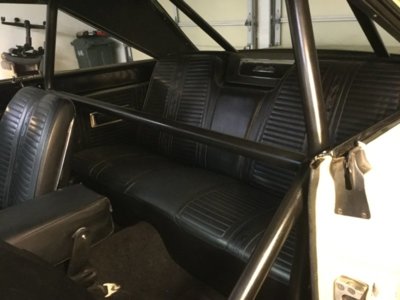

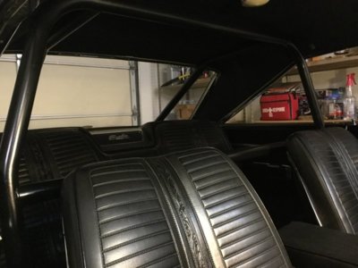

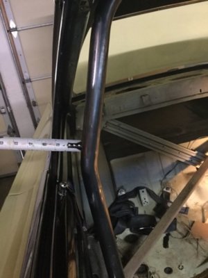

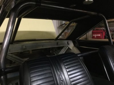

My 70' Challenger street car. Chrome moly 25.5 certified cage and chassis. All custom bent/made, all home built with the help of some buddies, still with stock firewall, floors and full interior. Can't sit back there but still has the rear seat. Two bars punch through rear seat to tie into upper spring perche's underneath .
100_1667 [640x480].jpg View attachment 736184 20150824_212638.jpg 20150504_074723_resized.jpg 20150424_205804_resized.jpg

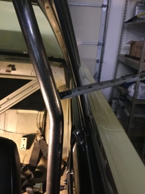

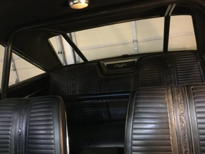

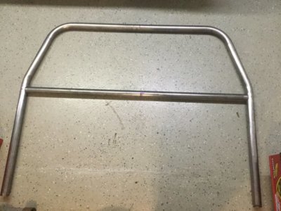

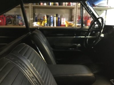

View attachment 736145 View attachment 736146 View attachment 736147 View attachment 736148 View attachment 736149
i don't have a tig welder guess i better look at some costs. the s and w kit looks good but i have a tube bender already. still lost which way to go but all you gots some great pics and want to thank you for taking the time to get some great pics. bearman

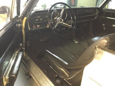

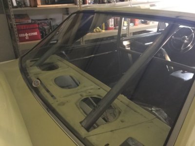

View attachment 736183 View attachment 736184 View attachment 736185 View attachment 736187 View attachment 736188
sweet set up and hand made aslo great work thank you.
