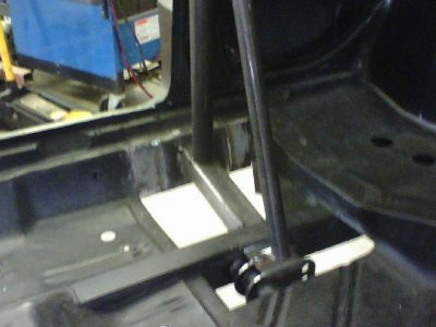

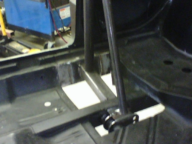

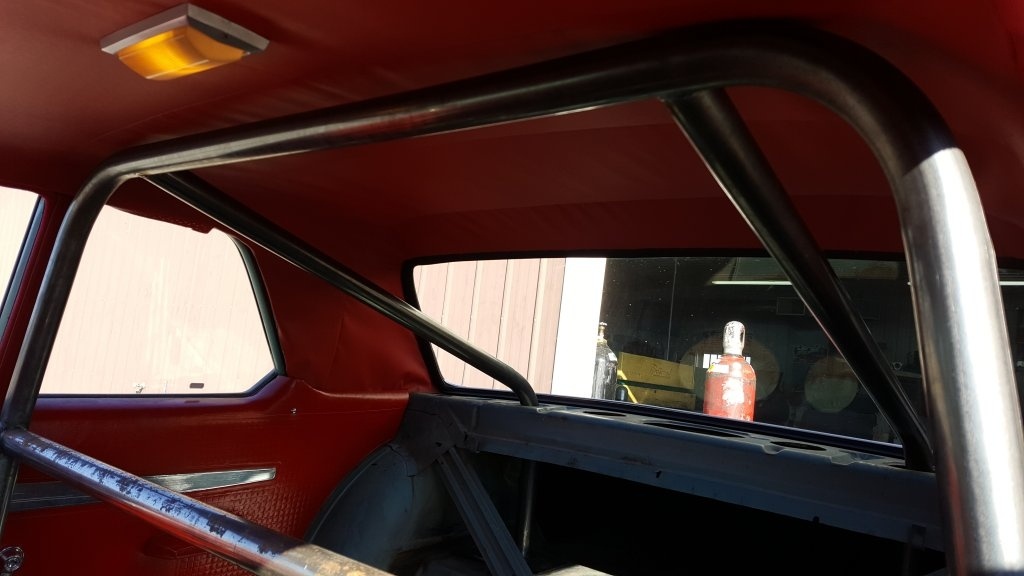

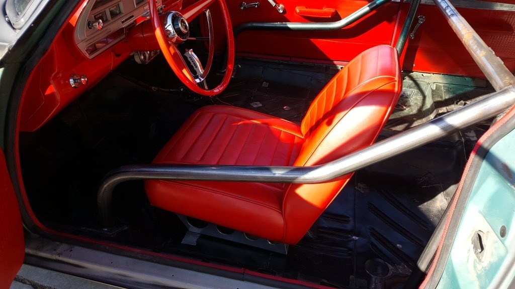

I was a first time installer, and the above worked well for me . also cut the floor and weld the frame connectors in the floor and the rear frame stubs. floor plates under the main hoop tied to the frame connectors in the floor. driveshaft loop welded to the frame connectors.

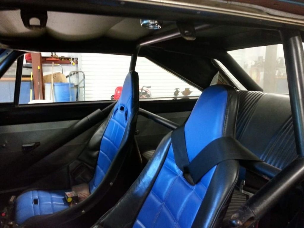

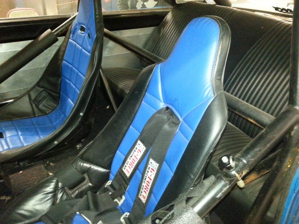

Pics of my new bar...
that looks good, similar to what ill end up putting in, did you add thew door bars yourself or was that part of the kit.
No kit.
I priced kits and a good, qualified welder to put it in. In the end it was less hassle and expense to take it to the local race car fab shop. Holzman's in Wichita did it.

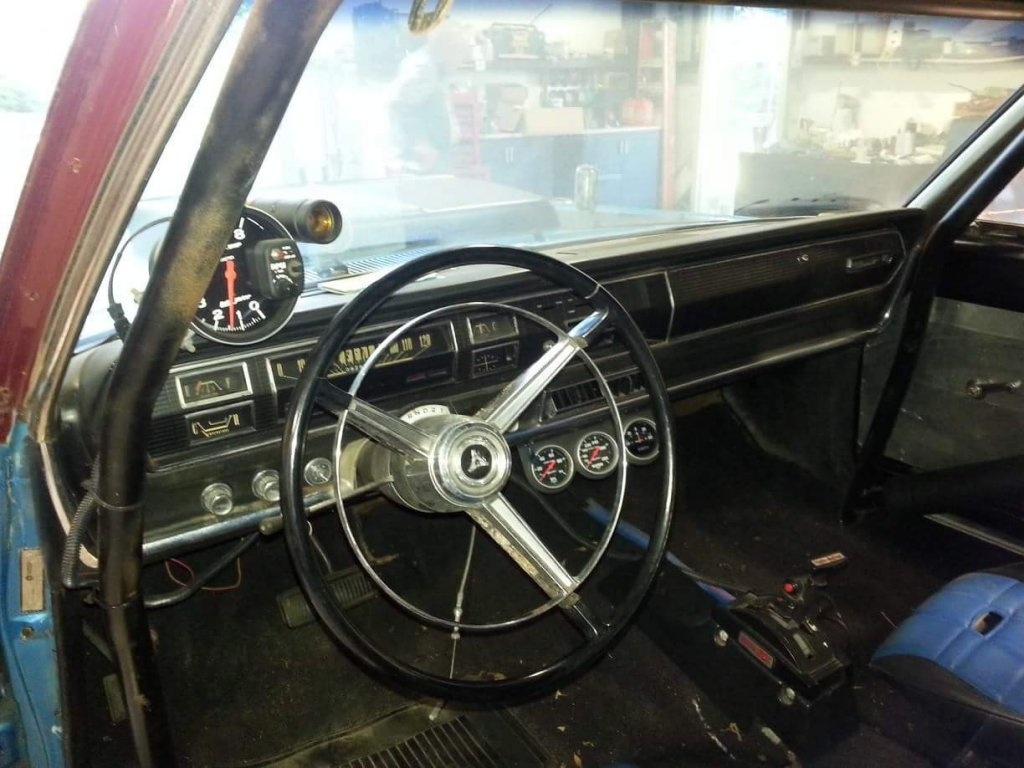

Here is some pics of mine, the only thing I'm changing are my door bars...
FB_IMG_1430761721574.jpg 20141108_192253.jpg FB_IMG_1430761393271.jpg FB_IMG_1430761740248.jpg
Thanks Mike, do the harness attach to the bar directly behind the seat?
Yes sir. The shoulder bar does have a reinforcement tab for the headrest as well.
I'm also thinking about using my factory seats, the problem is that the shoulder bar is just about the same height which is pretty dangerous in my opinion...so I've been toying with the idea of lowering it and also making it removable for the times the kids want to ride... It still wouldn't flex, the way its built...
