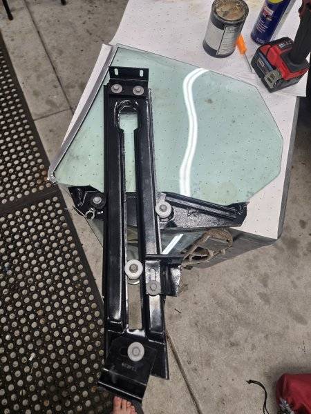

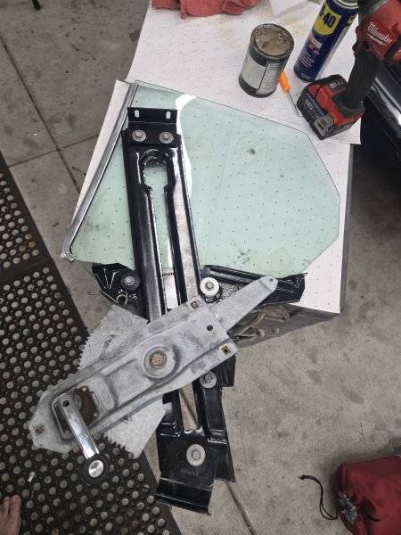

Simple... yet complicated to convert. I'm in the process of converting and couldn't figure out the brackets and mounting points. Looks like I'm missing the upper bracket. Which looks simple to fab up.

Thanks for the image. My setup is different. Doesn't have the aluminum on the bottom of the window and doesn't require the other channel.

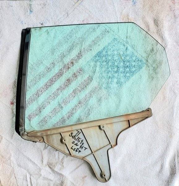

I can’t remember now if that assembly in the picture is out of my car or the parts car that I bought. Both windows came out of 71 Satellites and it appears that the picture from the service manual is the same and from what I can tell, the one in the Charger is very similar. What car did your window come from? A picture might help someone here identify.
I don’t know, it looks similar, but definitely different than what I have and seems to be missing parts. Have to look tomorow.

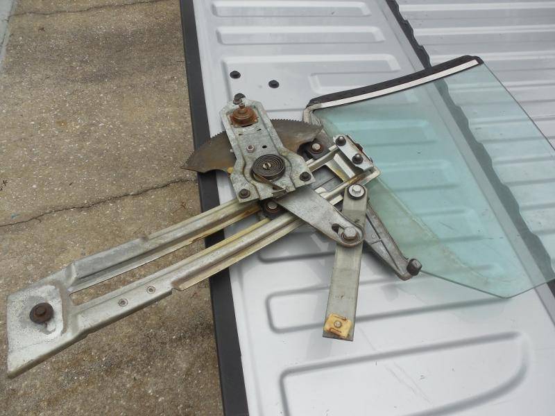

Ok I have spent an hour and a half this morning and time last night trying to research this and from what I can tell, the regulator will work on 71-74. It appears that the windows and tracks are more specific 71-72, 73-74. I looked at many eBay listings (if you can believe that) and they seem to bear that out. I looked at several old fbbo threads going back to 2010, but could not find a definitive answer.
One glaring thing that stands out to me is on the long track on my pic (it was the same on my other 71 car ) the slot at the top is sort of in the shape of an L , favoring one side as apposed to having the wide opening the same on both sides as most pics I see on eBay and your pic.
This pic on eBay says the window fits 71-72.
