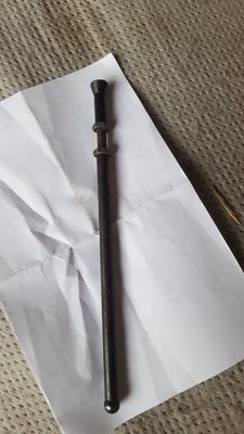

If you have the means, it's pretty easy to make a push rod checker.....
